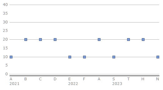

An index on the data would give you the exact chart you want without the year labels:
ie.
int[] idx = { 0, 1, 2, 3, 4, 5, 6, 7, 8, 9, 10 };
int[] year = { 2021, 2021, 2021, 2021, 2022, 2022, 2022, 2023, 2023, 2023, 2023 };
string[] label = { "A", "B", "C", "D", "E", "F", "A", "S", "T", "H", "N" };
double[] total = { 10, 20, 20, 20, 10, 10, 20, 10, 20, 20, 10 };
    //note an index (idx here) is not required for this add overload as it is automatically added, but it
    //helps to include it for clarity/understanding.
    for (int i = 0; i < 11; i++)
        points1.Add(total[i], label[i]);
        //or
        //points1.Add(idx[i], total[i], label[i]);
    tChart1.Axes.Left.SetMinMax(0, 50);
You can add the year to the label in this way, via the OnGetAxisLabel event:
private void tChart1_GetAxisLabel(object sender, Steema.TeeChart.GetAxisLabelEventArgs e)
    if (sender == tChart1.Axes.Bottom)
        if (e.ValueIndex != -1)
            e.LabelText = e.LabelText + "\n" + year[e.ValueIndex].ToString();
If you only want the year once, at the first value of the year for example, then you could setup the OnGetAxisLabel event in this way:
int lastYear = -1;
            if (lastYear != year[e.ValueIndex])
                e.LabelText = e.LabelText + "\n      " + year[e.ValueIndex].ToString();
                lastYear = year[e.ValueIndex];
There are other options, including putting the year to the centre of each range, but that requires a little more work…

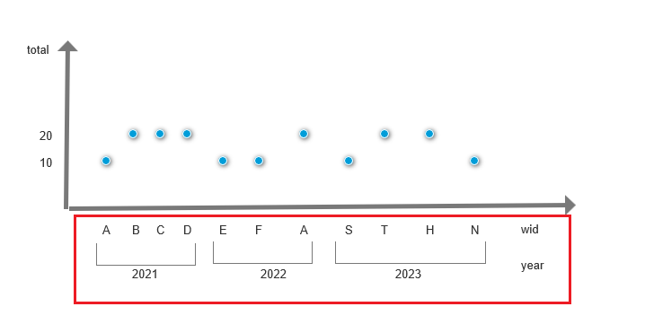

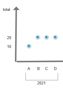

I want to custom the same year symbol, like the
or
Then I have try to use custom Drawing url,but failed.
how to draw the specified symbol above the year value
Could you help me please!
I hope the X look like
Through this result, I can directly see that A, B, C and D have the same year 2021.

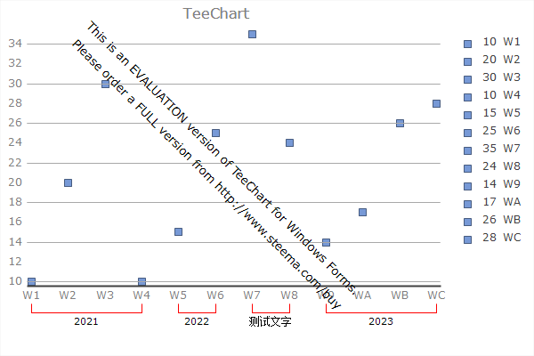

OK,I have draw the sample line.

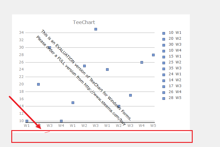

But i have the next trouble is how to resize the chart canvas that can leave the space to draw my custom symbol.
I want to stretch vertical direction, and the chart Bottom can't change. like the red rectangle.
thus i have the spce to show my custom symbol.

Posts: 1319
Location: Girona
Re: how to show the merged X axes?
Post by Marc » Thu Nov 09, 2023 10:01 am
Re.
See my last answer about Margins.
Re.
I have use tChart1.Axes.Bottom.CalcYPosValue(0) eg.. but i can‘t see the point
A point is a combination of X and Y
ie. tChart1.Axes.Bottom.CalcXPosValue(0), tChart1.Axes.Bottom.CalcYPosValue(0)
Substitute that into the last example I sent you to test it.

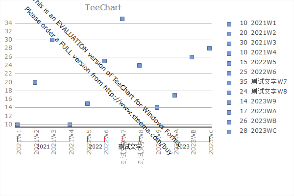

When i use the margin, i faced the new problem.
The normal image is :
if the x label is long ,then i set the angle to 90 caues the result
i use the code:
tChart1.Axes.Bottom.Position + symbolBase to calc the custom symbol y position.
The x label is dynamical.
So i want to know how to get the standard calc function to get the point Y value then they can't overlap each other

Post by Marc » Tue Nov 14, 2023 11:56 am
Here's an example how to dynamically modify the location of output relative to Axis Label angle. This example outputs a small test text sample.
  //declare var for max label width (length)
  double maxLabelWidth = 0;
  //then in Form_load or data refresh set:
  maxLabelWidth = tChart1.Axes.Bottom.MaxLabelsWidth();
  //will use radians for angle calcs
  public double ConvertToRadians(double angle)
    return (Math.PI / 180) * angle;
  //this example outputs test text in OnAfterDraw
  private void tChart1_AfterDraw(object sender, Steema.TeeChart.Drawing.Graphics3D g)
    double hyp = maxLabelWidth;
    //some simple trig:
    //sin(@) = opp/hyp
    //yDisp = opp  therefore  = hyp * sin(@)
    double angleRad = ConvertToRadians(tChart1.Axes.Bottom.Labels.Angle);
    double yDisp = tChart1.Axes.Bottom.Labels.Height; //minimum
    if ((tChart1.Axes.Bottom.Labels.Angle >= 0) && (tChart1.Axes.Bottom.Labels.Angle < 180))
      yDisp = yDisp + Math.Sin(angleRad) * maxLabelWidth;
      yDisp = yDisp + Math.Sin(angleRad) * maxLabelWidth * -1;
    g.TextOut(10, (int)(tChart1.Axes.Bottom.Position + yDisp), "test label");
