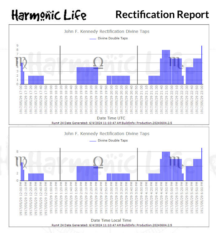

I have an app that works fine with modern dates.

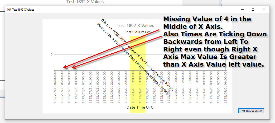

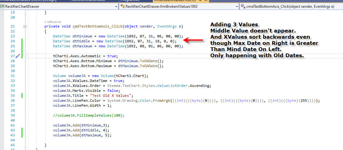

But I tried to run a chart yesterday with dates from 1892 and the Bottom (XValue) Axis doesn't show values in the middle of the XAxis.
Only values on the left and right sides of the chart show -- which is weird.
I've attached some screenshots and the sample project --
Thanks for your help.
Joseph

This is not something for which we can apply a quick fix to the code so we'll need to know a little about the type of use you envisage, ie. whether all your dates in a chart will be restricted to the pre Dec 1899 period or whether you expect a mixture of pre-post 1899 mixes in a single chart? ... or whether showing just whole day increments may be sufficient.
The problem (for us as chart designers) comes down to the date implementation by Microsoft for Windows. The zero date being midnight, 30 December 1899.
Note from the reference here:
https://learn.microsoft.com/en-us/dotne ... ew=net-8.0
An OLE Automation date is implemented as a floating-point number whose integral component is the number of days before or after midnight, 30 December 1899, and whose fractional component represents the time on that day divided by 24. For example, midnight, 31 December 1899 is represented by 1.0; 6 A.M., 1 January 1900 is represented by 2.25; midnight, 29 December 1899 is represented by -1.0; and 6 A.M., 29 December 1899 is represented by -1.25.
That makes it easy to handle whole days linearly, as they count back from 0. 1 being 29th Dec 1899, 2 being 28th, etc. But the inconvenience is that the fractional part of each day, 1/24 being one hour, is also counted backwards meaning that a simple date conversion in a table is no problem but that visually, on a chart, time goes backwards from the 30 December 1899.
For a chart merely showing whole days that is fine but to resolve that for each incremental fraction of the day requires inverting the fractional part of each integer (day) segment for any day-time data to plot correctly. We are looking at options.

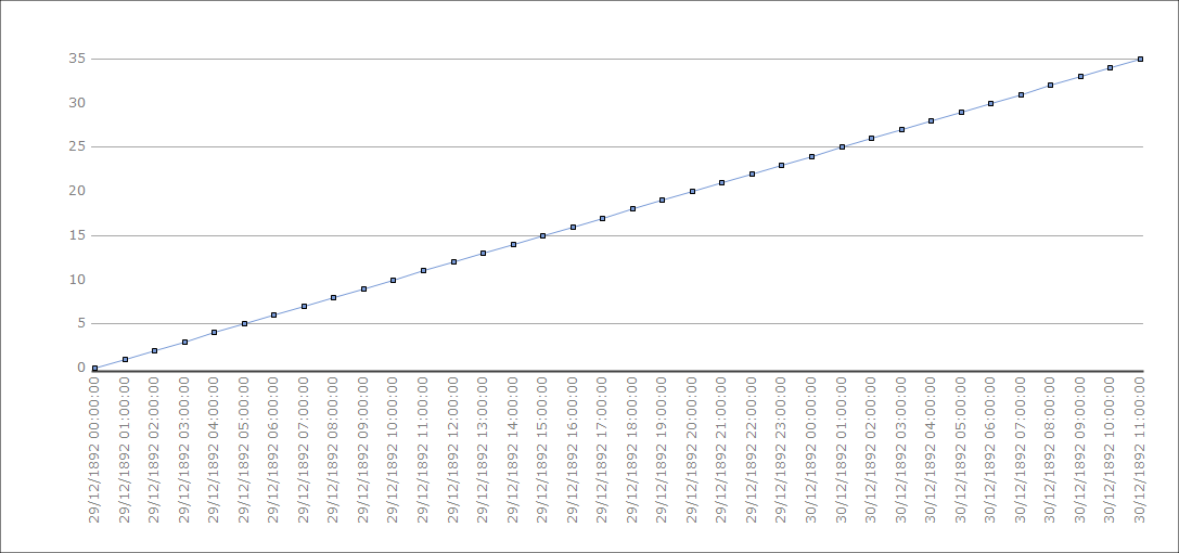

If your charts are showing one full day or less then we may have a straightforward solution, to invert the Axis.
This sample code for example:
DateTime startDate = new DateTime(1892, 12, 29, 0, 0, 0);
if (startDate.ToOADate() <= 0)
    tChart1.Axes.Bottom.Inverted = true;
for (int i = 0; i < 24; i++)
    DateTime currentDayTime = startDate.AddHours(i);
    tChart1[0].Add(currentDayTime, i);
tChart1.Axes.Bottom.Labels.DateTimeFormat = "dd/MM/yyyy HH:mm:ss";

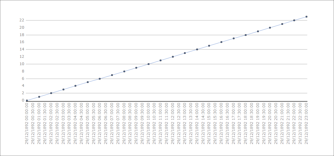

An alternative workaround suggestion: Assuming that the range for the x-axis could exceed one day then perhaps the easiest thing to do would be to move the dates to a workable range and then modify the year label.
ie.
bool pre1900 = false;
int dateYear;
        startDate = startDate.AddYears(100);
        dateYear = startDate.Year;
        pre1900 = true;
    for (int i = 0; i < 36; i++)
private void tChart1_GetAxisLabel(object sender, GetAxisLabelEventArgs e)
    if ((sender == tChart1.Axes.Bottom) && (pre1900))
        e.LabelText = e.LabelText.Replace(dateYear.ToString(), (dateYear-100).ToString());
I hope that something in there may prove useable.
