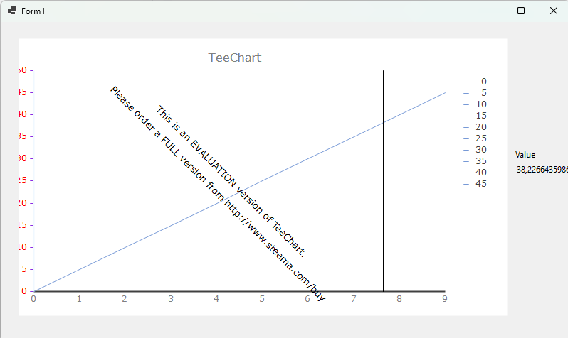

Finally, this is an example of how it would look like, using a label on the right of the chart to show the value:
Hope this helps, if there's anything else that I can help you with, please let me know!
