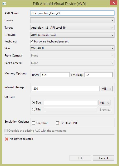

Ok, thanks. I tried creating an emulator with a similar specifications but couldn't reproduce the problem there either. Can you reproduce the problem with different devices? I'll also try to test with some other devices. That's the emulator I created. Shouldl I change anything? Did you reproduce the problem with a similar emulator?
I think the emulator settings is correct. I haven't test it in an emulator because it's too slow and the emulator itself is hardly starting during debugging. I sent a video regarding my problem. Hope it helps.

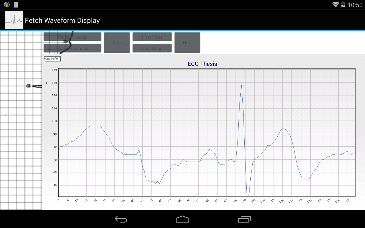

Continuing with this, commenting out the ScrollView related code at FetchWaveformLayout.axml does exactly the same as with the ScrollView on it:
        <!--<ScrollView
            p1:minWidth="25px"
            p1:minHeight="25px"
            p1:layout_width="match_parent"
            p1:layout_height="match_parent"
            p1:id="@+id/scrollView1"
            p1:fillViewport="true">
            <LinearLayout
                p1:orientation="horizontal"
                p1:minWidth="25px"
                p1:minHeight="25px"
                p1:id="@+id/linearLayout3" />
        <!--</ScrollView>-->
This is how it looks like. Notice the layout is not looking very good in a Nexus 7 tablet. Anyway, it was exactly like this with the ScrollView.
Correctly if I'm wrong because I'm still seeing the page numbering in the picture does the graph in the picture actually scrolls?

JAP wrote: Correctly if I'm wrong because I'm still seeing the page numbering in the picture does the graph in the picture actually scrolls?
Yes, it scrolls as per the ZoomStyles.FullChart functionality.
