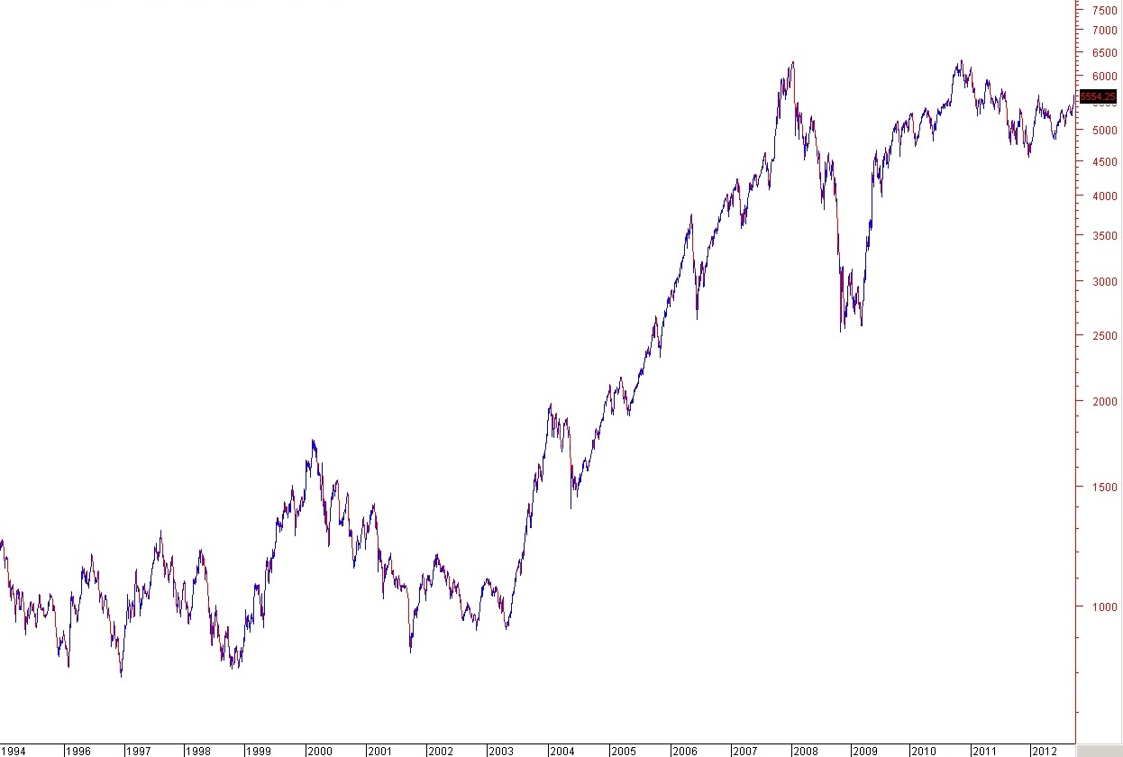

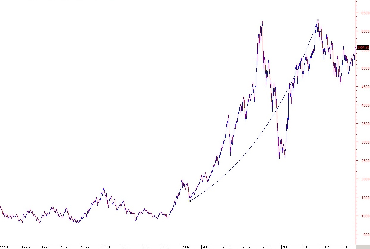

We are starting this discussion again to discuss "Semi-Log Trendline" in more detail, thereby we can help each other to solve this requirement.
Note: Following steps are based on usage of "Semi-Log Trendline" from a popular charting software.
Step 1] Consider a chart (OHLC with Candle Line) with Right Axis Semi Log Scaled as shown in below screenshot (Screen 1).
Screen 1
Step 2] Now a User Draws a "Semi-Log Trendline" on a Chart by using "Semi-Log Trendline" Tool as shown in below Screenshot (Screeen 2).
As shown in "Screen 2" it shows straight line drawn on semi log scaled chart.
Screen 2
Step 3] When user changes Semi log scale to Arithmetic scale, then previously drawn straight line becomes a curved line as shown in below screenshot (Screen 3).
Screen 3
Above three steps comprises of Semi Log Trendline working.

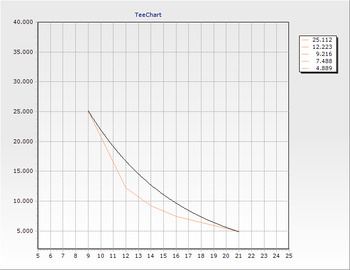

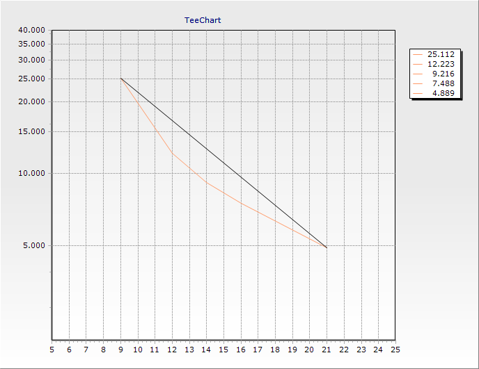

Re: Trendline with Snap to Point & Semi log Aware Trendline
Post by Christopher » Mon Feb 22, 2016 12:05 pm
Quant wrote: Above three steps comprises of Semi Log Trendline working.
Here it is working in TeeChart:
    Line series;
    DrawLine tool;
      series = new Line(tChart1.Chart);
      series.Add(9, 25112);
      series.Add(12, 12223);
      series.Add(14, 9216);
      series.Add(16, 7488);
      series.Add(21, 4889);
      tChart1.Axes.Left.SetMinMax(2000, 40000);
      tChart1.Axes.Bottom.SetMinMax(5, 25);
      tChart1.Axes.Left.Increment = 5000;
      tool = new DrawLine(tChart1.Chart);
      DrawLineItem line = new DrawLineItem(tool);
      line.StartPos = new PointDouble(9, 25112);
      line.EndPos = new PointDouble(21, 4889);
      tool.Lines.Add(line);
    private List<PointDouble> CalcCurve()
      List<PointDouble> result = new List<PointDouble>();
      Point start = new Point(tChart1.Axes.Bottom.CalcXPosValue(tool.Lines[0].StartPos.X), tChart1.Axes.Left.CalcYPosValue(tool.Lines[0].StartPos.Y));
      Point end = new Point(tChart1.Axes.Bottom.CalcXPosValue(tool.Lines[0].EndPos.X), tChart1.Axes.Left.CalcYPosValue(tool.Lines[0].EndPos.Y));
      double dxdy = (double)Math.Abs(start.X - end.X) / (double)Math.Abs(start.Y - end.Y);
      int count = 0;
      for (int i = start.Y; i <= end.Y; i++)
        result.Add(new PointDouble(tChart1.Axes.Bottom.CalcPosPoint(start.X + Utils.Round(count * dxdy)), tChart1.Axes.Left.CalcPosPoint(i)));
        count++;
      return result;
      if(tChart1.Axes.Left.Logarithmic)
        List<PointDouble> list = CalcCurve();
        Line newLine = new Line(tChart1.Chart);
        newLine.Color = Color.Black;
        newLine.Legend.Visible = false;
        tChart1.Legend.LegendStyle = LegendStyles.Values;
        foreach (var item in list)
          newLine.Add(item.X, item.Y);
        tool.Active = false;
        if(tChart1.Series.Count > 1)
          tChart1.Series.RemoveAt(1);
        tool.Active = true;
      tChart1.Axes.Left.Logarithmic = !tChart1.Axes.Left.Logarithmic;
Step 1:
Step 2:
This is just a proof of concept that TeeChart is capable of rendering this change from [straight line in log] -> [curve in non-log] ... the actual implementation of this in your context may be a little different.
