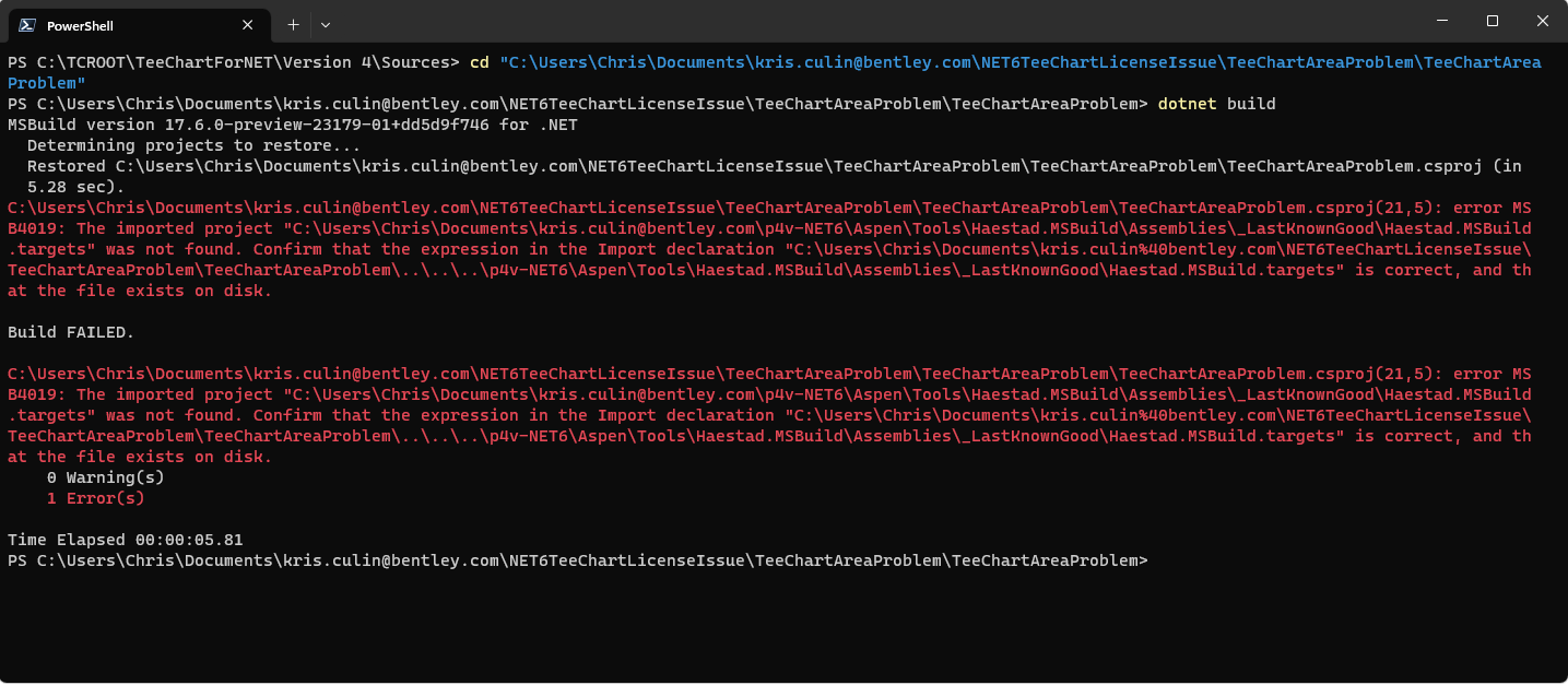

I'm afraid I can't build your project here, as it seems to be missing some dependencies—are these important to the reproduction of the problem? Can you reproduce the problem at your end without these dependencies?

Okay, I can run the project deleting:
    <Import Project="$(MSBuildProjectDirectory)\..\..\..\p4v-NET6\Aspen\Tools\Haestad.MSBuild\Assemblies\_LastKnownGood\Haestad.MSBuild.targets" />
    <Target Name="CopyBitSpecificLKG" AfterTargets="PostBuildEvent">
        <CopyToLastKnownGood SourceFiles="$(MSBuildProjectDirectory)\TeeChart.licenses" DestinationFolder="$(TargetDir)" />
    </Target>
From the TeeChartAreaProblem.csproj.

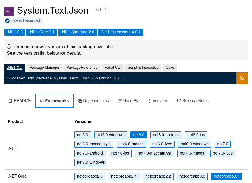

I recall you mentioning either in this post or another that you'll be fixing the System.Text.Json dependency.
Is there any particular reason why you are referencing 7.0.0 when the TeeChart control targets .NET 6? It's causing some major conflicts for us.
When we try to use TeeChart in ArcGIS Pro, which is .NET 6, it is trying to load System.Text.Json v7.0.0 and it can't be found.
Would it be possibly for you to simply target System.Text.Json v6.0.0?
Kris

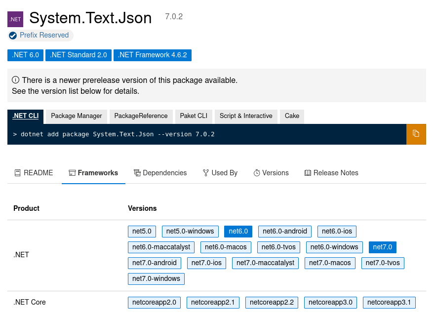

Post by Christopher » Tue Apr 18, 2023 7:41 pm
Hello Kris,
If I'm not mistaken, the latest version of System.Text.Json, version 7.02, supports both net60/net60-windows as well as net70/net70-windows.
Screenshot from 2023-04-18 21-37-58.png (75.6 KiB) Viewed 62515 times
This situation, of supporting both net60/net60-windows as well as net70/net70-windows, is identical to version 6.07:

This being the case, I'm afraid I can't see the advantage in downgrading the version in TeeChart—maybe you could explain it to me so I can reproduce the issue here.

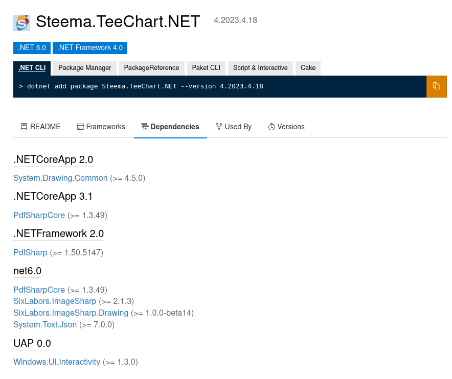

The new TeeChart NuGet is now available here. As you can see from its dependencies:
Screenshot from 2023-04-19 08-44-58.png (87.52 KiB) Viewed 62502 times

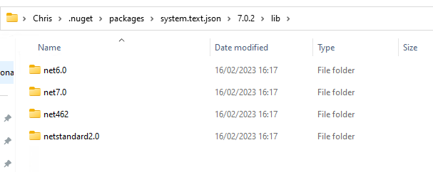

For net6.0 it is dependent on System.Text.Json (>=7.0.0). If you look on your hard disk for the version we use, v.7.0.2, you will see:
Screenshot from 2023-04-19 08-44-31.png (14.88 KiB) Viewed 62502 times
Note the presence of the net6.0 folder—this means that System.Text.Json 7.0.2 is built against net6.0 and is compatible with it. It is not erroneous to reference System.Text.Json 7.0.2 in a net6.0 assembly such as TeeChart.
I suggest you run some tests with this new NuGet and see what happens. It may be that your problems with this version of System.Text.Json are insurmountable, in which case we might have to consider a special build for you. What we would prefer not to do is to unnecessarily downgrade System.Text.Json for all clients of our product.
