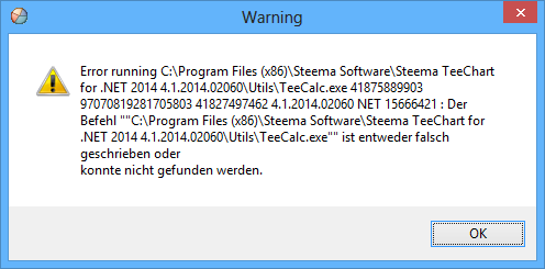

See the Picture ....
Reinstall will not work ...

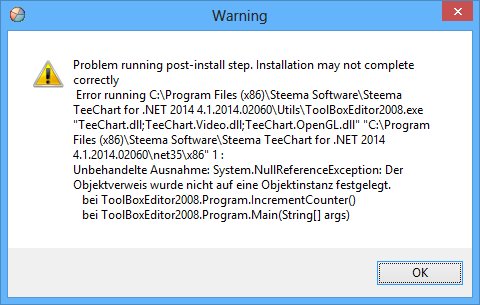

Unfortunately, this is a limitation with the present installer which will be resolved for the next maintenance release.
To obtain the net35 assemblies, please re-run the installer *selecting a unique folder name* and choose the VS2008 option.

I tried to do this, but an Hreg tool has Errors.
And the ChartEditor is not found in Registry ....
It don't works ...

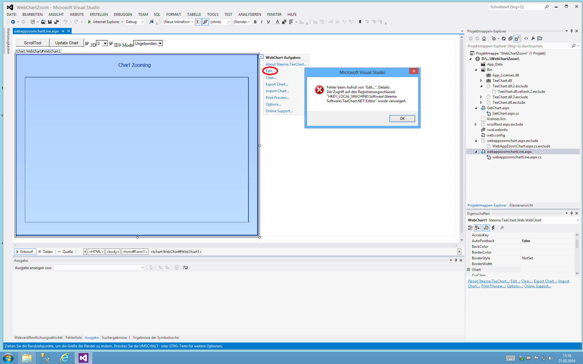

We use
We need both Framework 3.5 and 4.5 for VS2012 ( 'Windows 8' ) !
Error ..

Does this error occur if you run the VS2012 as "run as Administrator"?
If the error doesn't occur when you run the VS2012 IDE as "run as Administrator", then please do so for now. This is a known issue in the binaries you have and has already been fixed; the fix will become available in a new maintenance release due out within the next two or three working days.

Post by ikke » Fri Feb 21, 2014 10:32 am
No
I hope...
Can i hope ?
Do you read the whole posts of the topic ?
I'm waiting ... for the next release !
