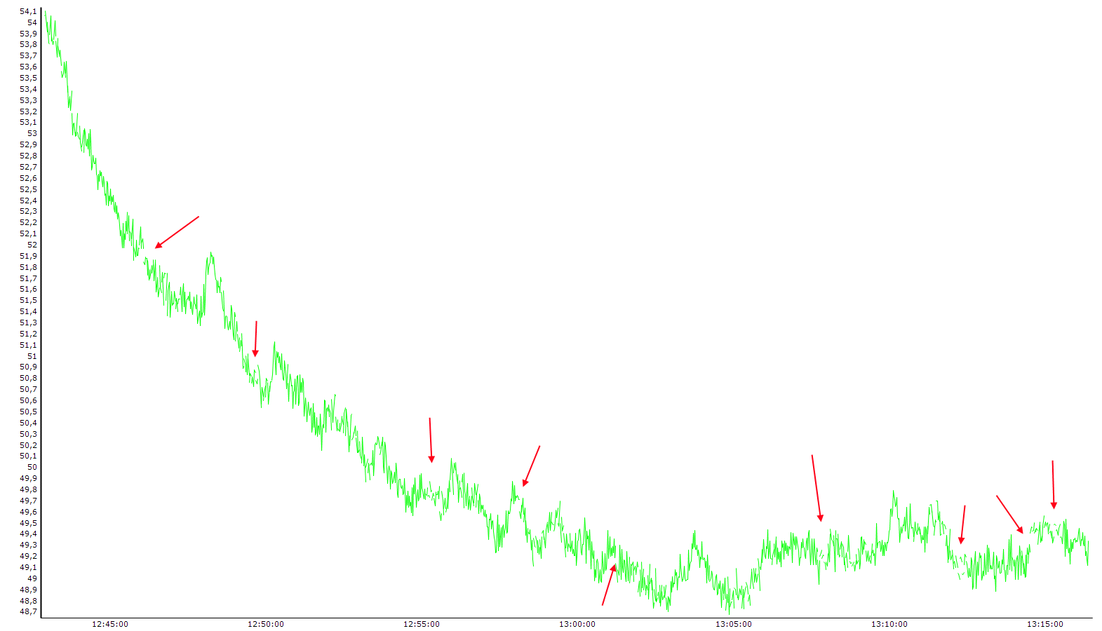

I have a graph, containing a single FastLine series. All the points should be connected, but in the graph, it appears to have blank segments.
I exporting the values in the series using:
using (TextWriter writer = new StreamWriter(fileStream, Encoding.UTF8))
foreach (Series series in graphChannels.Series)
writer.WriteLine(series.Title);
int count = Math.Min(series.XValues.Count, series.YValues.Count);
for (int i = 0; i < count; i++)
writer.WriteLine("{0}\t{1}", series.XValues, series.YValues);
And imported it into Excel, to see if there really is any null values in the series - but I have not found any.
The series data, with X/Y-plot can be found here: http://www.bendtsen.net/export.xls
Any advise on how to resolve this?

The TeeChart version is 3.5.3425.20243 using Framework 3.0 on a Windows XP machine.

Post by Yeray » Wed Jul 15, 2009 2:37 pm
Hi Soren,
I've saved your xls as csv and imported it to a chart and I couldn't see any gap. Here is the code I used:
        FastLine fast1;
            chartController1.Chart = tChart1;
            fast1 = new FastLine(tChart1.Chart);
            TextSource textsource1 = new TextSource("H:\\yeray\\examples\\Soren\\test.csv");
            textsource1.DecimalSeparator = ',';
            textsource1.Separator = ';';
            fast1.DataSource = textsource1;
            textsource1.Fields.Add(0, "X");
            textsource1.Fields.Add(1, "Y");
            fast1.CheckDataSource();
Could you please attach here a simple example project we can run as-is here to reproduce the problem here?
