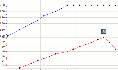

I have added two custom axis to my chart with start and end positions of 100,50 and 50,0 respectively. When the page loads for the first time the axes min and max's are set to automatic (i.e. the scales automatically adjust to the min and max series values - see image1 - the blue series min is 120).

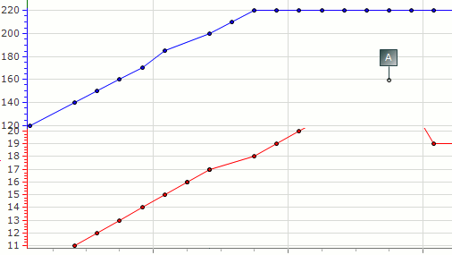

I have provided the end user with the ability to customize the axes min and max's, i.e. to allow them specify a min and/or max value to which to scale the axis. When the chart is redrawn I get data overlapping between the two series - see image2 - this is what happens when the blue axis min is set to 160. Note the blue series is now overlapping the red series.
To change the scale I set the blue axis Automatic property to false and then set the axis Minimum property to the desired value e.g. 160, for example:
axis.AutomaticMinimum = False
axis.Minimum = 160
Is this correct? The desired effect I was expecting was that the first 3 points in the blue series would no longer be visible (see image3 which I edited to illustrate the desired result).

I have annotations attached to some points and if the points are hidden the annotations are still displayed (see below - image1 is before the chart is rescaled, image2 is after the chart is rescaled - note the annotation 'A' is still visible). I'd like to hide such annotations. Can you suggest how best to achieve this? Currently I position the annotations in the charts AfterDraw event after getting the location of the point to which to attach it to, e.g.:

Post by Yeray » Tue Jul 21, 2009 8:02 am
Hi Norman,
I can't see any difference between the two codes you posted. Anyway, adding this code in the AfterDraw event should hide your annotation when the point is out of its axis range:
        If (TChart1(seriesIndex).YValues(pointIndex) < TChart1(seriesIndex).GetVertAxis.Minimum) Or (TChart1(seriesIndex).YValues(pointIndex) > TChart1(seriesIndex).GetVertAxis.Maximum) Then
            annotation.Active = False
        Else
            annotation.Active = True
        End If

Posts: 9701
Re: Axis scaling and overlapping data
Post by Yeray » Tue Jul 21, 2009 9:45 am
Hi Norman,
Yes, this code looks nice.
