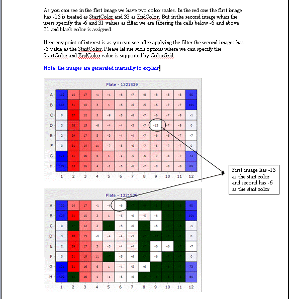

Dear Sandra,
Please see the attachment to understand my requirements and reply. I had gone through your link and it will not serve my purpose.

Re: ColorGrid reset the StartColor & EndColor values
Post by Sandra » Tue Jul 28, 2009 10:57 am
Hello vivek,
I think, you should assign a palette for each of the color grids. Please, try to assign the palettes, and check that solve your problem.
I hope that will helps.
Post by Sandra » Thu Jul 30, 2009 8:17 am
Hello vivek,
I have made an example, that you could use for solve your problem of ColorGrid using 2 palettes. Please check that next example solve your problem.
