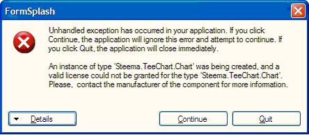

I just installed an application using TeeChart .NET on a target machine and it throws an exception.
An instance of type 'Steema.TeeChart.Chart' was being created. and a valid license could not be granted for the type 'Steema.TeeChart.Chart'. Please, contact the manufacturer of the component for more information.
Error message

Hi prle,
Please read the thread below about the same issue:
http://www.teechart.net/support/viewtopic.php?t=6711
You may also want to check the examples included with the installation which include licenses.licx compiled as an embedded resource.
