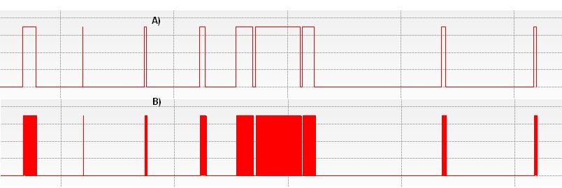

I would like to create chart with states. Now I've solved the problem by using line series like at the picture A),
but I would like to get something like at the picture B). Is there any series that give such a possiblity ?
[img]states.JPG[/img]

Hi jarp,
I think that the series you are looking for is the Area series:
            Area area1 = new Area(tChart1.Chart);
            area1.Color = line1.Color;
            area1.LinePen.Color = area1.Color;
            area1.DataSource = line1;
            area1.UseOrigin = true;
            area1.Origin = 0;

Thanks a lot. Your solution works.
