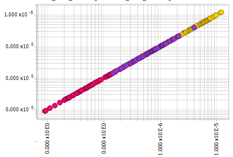

Hello~
When draw the chart with very small value (under 1E-7)
, Teechart cannot display label in "Exponential format".
In case of 1.0x10E-7 , it display like "0.0x10E0 ".
And additionally,
when angle of labels isn't 0 degree, it cannot display as well.
Like attached image,
eventhough format of left and bottom Axis are same, bottom axis doesn't display in "Expoenetial" format.
We often handle very small value.

Post by Sandra » Fri Aug 21, 2009 8:39 am
Hello kiolol,
I could reproduce your problem using last version of TeeChart .Net. I have added this in list of Bug Reports with number [TF02014354]. we will try to fix it for next versions of TeeChart .NET.
