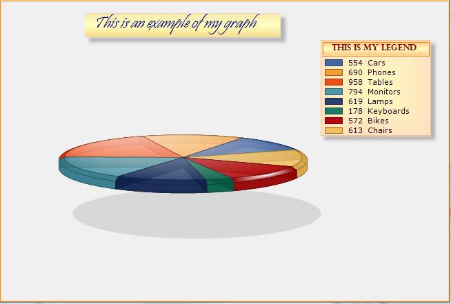

Hi UserLS,
I've tried to obtain a chart similar to yours with the following code:
            chartController1.Chart = tChart1;
            tChart1.Aspect.Chart3DPercent = 50;
            tChart1.Aspect.SmoothingMode = System.Drawing.Drawing2D.SmoothingMode.AntiAlias;
            tChart1.Header.Text = "This is an example of my graph";
            tChart1.Header.Transparent = false;
            tChart1.Header.Gradient.Visible = true;
            tChart1.Header.Shadow.Visible = true;
            tChart1.Header.Shadow.Height = 10;
            tChart1.Header.Shadow.Width = 10;
            tChart1.Header.Shadow.Color = Color.LightGray;
            tChart1.Header.Shadow.Smooth = true;
            tChart1.Header.Font.Name = "Gabriola";
            tChart1.Header.Font.Italic = true;
            tChart1.Header.Font.Size = 18;
            tChart1.Legend.Title.Text = "THIS IS MY LEGEND";
            tChart1.Legend.Title.Visible = true;
            tChart1.Legend.Title.Gradient.Visible = true;
            tChart1.Legend.Shadow.Height = 10;
            tChart1.Legend.Shadow.Width = 10;
            tChart1.Legend.Shadow.Color = Color.LightGray;
            tChart1.Legend.Gradient.Visible = true;
            tChart1.Legend.Shadow.Smooth = true;
            Pie pie1 = new Pie(tChart1.Chart);
            pie1.FillSampleValues();
            pie1.Transparency = 50;
            pie1.BevelPercent = 10;
            pie1.EdgeStyle = Steema.TeeChart.Drawing.EdgeStyles.Curved;
            pie1.Shadow.Height = 350;
            pie1.Shadow.Color = Color.LightGray;
            pie1.Marks.Visible = false;
            pie1.Shadow.Visible = true;
            tChart1.Aspect.Elevation = 290;
            tChart1.Export.Image.Metafile.EMFFormat = System.Drawing.Imaging.EmfType.EmfPlusOnly;
            tChart1.Export.Image.Metafile.Save("C:\\tmp\\test.emf");
The result is a metafile that could be probably improved in quality (I've added this to the wish list to be enhanced for further releases [TF02014378]) but I'm not able to reproduce your problem with the shadows. Could you please try it and see if the shadows are correctly exported?

Thanks! This works a lot better! As you've mentioned, the quality could be better, but with all the changes you've suggested, our output now is at least not worse (and in some cases better) than the Win32 version.
