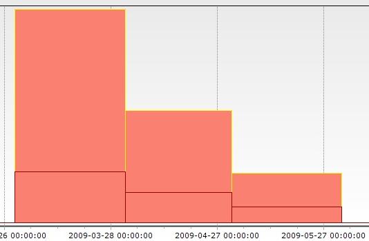

I have a problem with additional frame between two area charts.
In the picture below:
are two series of Area type. Frames for both are set to Color.Yellow: area1.LinePen.Color = Color.Yellow; .
How to remove the border (frame) between two charts (in the picture it is in red like color) ?

Hi jarp,
It works fine for me here setting both series like this:
				area1.LinePen.Visible = false;
				area1.AreaLines.Color = Color.Yellow;
For example:
			for (int i = 0; i < 2; i++)
				Steema.TeeChart.Styles.Area area1 = new Steema.TeeChart.Styles.Area(tChart1.Chart);
				area1.Color = Color.Red;
				area1.MultiArea = Steema.TeeChart.Styles.MultiAreas.None;
				area1.Stairs = true;
				for (int j = 0; j < 5; j++)
					area1.Add(j * (i+1));
			tChart1.Series.Exchange(0, 1);
Can you please check if this works fine for you?

Yes, everything works fine.
