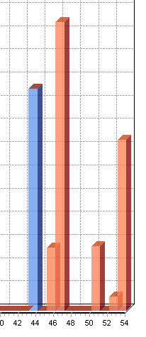

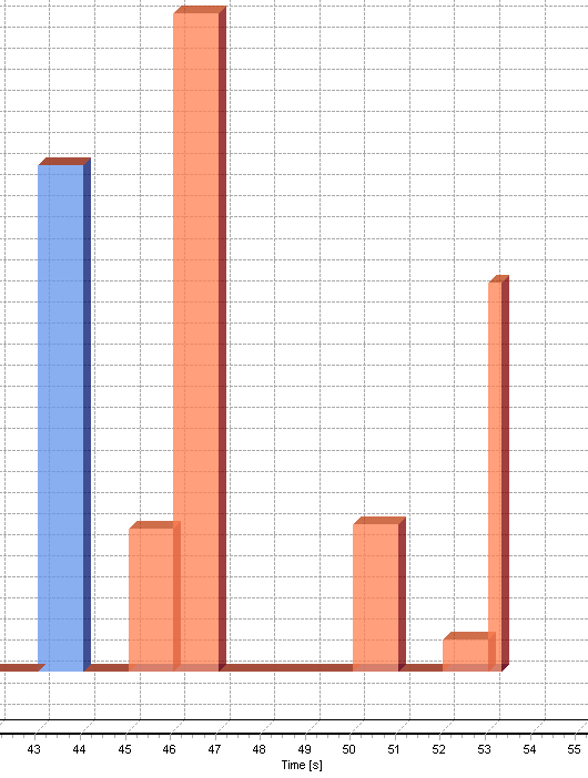

The fact is that the right most column ( x is growing ---> ) keeps it's width when I zoom in (either with the mouse and also manual, from code). Note that the height is changed OK.
If, in the Zoomed event, I manually modify the CustomWidth property of the corresponding Bar Item , the width is changed. But I don't know the right value here to "hack" the last column to zoom OK (the other Bar items seem to return the normal 100% view width).

BarWidthPercent = 100; This makes the bars to occupy the entire space between them.
Steps to recreate:
Without hack:
- zoom on the right most side
- the last column has different width
With hack:
- now the last column has the right width
- there's a residual space left because the hack introduces an invisible column to "take the hit".

Here's the movie:
http://dl.transfer.ro/show-9d22f001d.zip
I'm sorry it's without sound, but I don't have a mic at hand for the moment.
You should be able to see that the width of the right most column remains the same on zoom, and with the "hack" active
the invisible column introduced takes the "hit" and the real right most column zooms OK.
