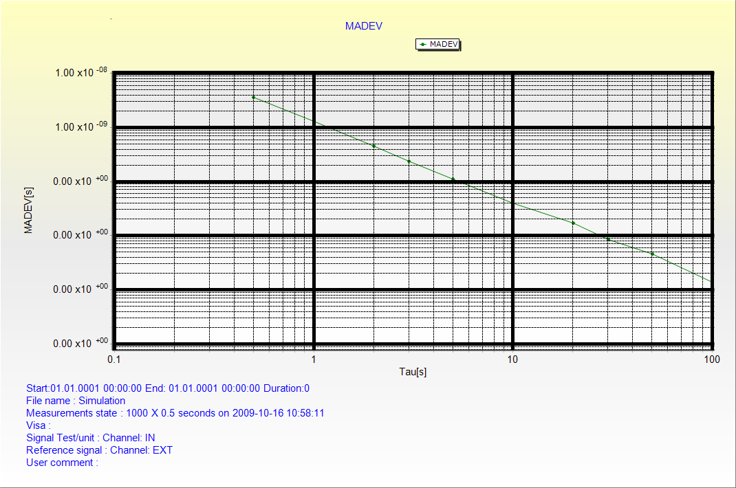

I am having problems while setting labels on logaritmic Y Axis. The values aren't displayed correctly except two highest ones.
The values
0.00 x 10-13;
0.00 x 10-12,
0.00 x 10-11,
0.00 x 10-10,
1.00 x 10-09,
1.00 x 10-08 : are displayed in place of
1.00 x 10-13,
1.00 x 10-12,
1.00 x 10-11,
1.00 x 10-10,
1.00 x 10-09,
1.00 x 10-08
Can any one help!
The attachment Logaritmic labels.png is no longer available
Logaritmic labels.png (62.72 KiB) Viewed 2834 times

I sow my problem was reported as bug [TF02014354].
Will it be fixed and when?

This should have been fixed with the TeeChart for .NET [24 SEP 2009] RELEASE 4.0.2009.35590/1/2 as you can see in the release notes:

But I am using 3.5.3498.27386 with vs2008 and the download link goes to the same version.
Do I need an other licence?
Every thing was OK on logarithmic axes before passing from version2 to version3.

Note that we focus our efforts on improving and fixing the bugs for the current release and we only fix the problems for the previous versions when they are very critical and/or they don't imply a too high modification on the sources.
Also note that this will change with the new subscriptions system.
