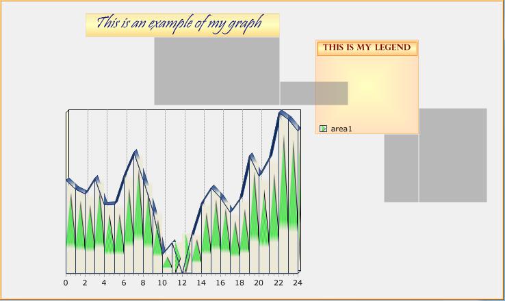

There are general problems with how shadows are displayed when the size is big enough.
I am just playing with chart editor and set Title's shadow offset to (100, 100).
As you can see on my attachment, the title's shadow is more then just strange with a lite vertical line (which you cannot get rid of at all).
Also, my legend's title shadow is not visible, but still the legend reserves the vertical space for it.
Yes, I know that I could use "smooth" mode, which has fewer bugs and displays quite nice... but here is the problem - it is not included into PDF, when exported, and I do not need a graph at all, if I cannot export it to PDF.
Also try to set the shadow offset to (3, 3) and the shape's frame width to 10 or 15. Now your shadow is inside the frame!

Hi UserLS,
Yes, you are right. I've added this to the wish list to be fixed in further releases (TF02014515).

Just to make sure, you'll know about all problems here:
  • If you enter a negative number for the horizontal offset - it is treated as positive value (so 60 and -60 is the same value???)
  • if you enter a negative value for the vertical offset (and I tried to do it with Legend and Title) - it's not just ignoring the negative sign, but it also resizes your graph in a very strange way!

With the latest build the shadows on shapes are working slightly better. My question is: if you did work in this area, why not fix it for good. As of now, if you have your title shape style set to Rectangle, than the location of the shadow is calculated correctly (as long as your vertical offset is positive - negative offsets are still badly broken and do not survive round-tripping through templates). But if you change the shape to be RoundRect - the shadow jumps (looks like all the offsets are doubled). And another problem - Rectangle shape and vertical offset is such that the shadow is supposed to be below the frame (not even touching it)... well, try to do it. I always have an extra rectangle connecting the shape with the shadow.
