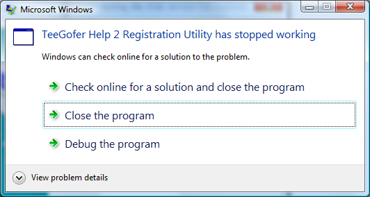

Hi again,
Here is the error message:
Please see the attached file!
Here is my TeeChart info:
Steema.TeeChart.TChart, TeeChart, Version=3.5.3498.27368, Culture=neutral
One IMPORTANT thing is: During installation, Ms./Mr. TeeGofer_H2reg.exe can not play with my Vista Business or my Windows 7 Enterprise registries!
I think that some registry entries are not registered, then cause Setup/deployment issue. but design-time is still OK!
Plz consider
Plz consider
- TeeGofer_H2reg failed
- Gofer Teechart.png (40.98 KiB) Viewed 7093 times
- TeeChart run-time License not granted!
- TeeChart error.png (4.81 KiB) Viewed 7093 times
Re: TeeChart .Net Run-time deployment error?
Hi Peter,
If you say new applications works fine for you and only old applications fail, could you please verify again all the steps I mentioned in the thread I pointed you for the failing application/s? If any problem occurs could you please let us know at which step did it fail?
BTW: Is the failing application a standalone WinForms project or is a more complex solution?
Are you running the installer with administrator rights? You can right-click on it an select "Run as Administrator".One IMPORTANT thing is: During installation, Ms./Mr. TeeGofer_H2reg.exe can not play with my Vista Business or m
