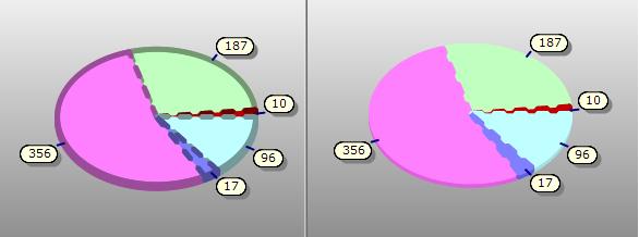

UserLS
Posts: 247
Re: Pie charts - border
Post by UserLS » Fri Dec 18, 2009 6:30 pm
Ok, here is the same pie chart with border visible and not:
Pie chart - Borders.jpg (13.89 KiB) Viewed 16307 times
By the way, why the setting of line type applies only to the dividing lines and legend symbols, while the width is applied to all borders?
Posts: 9701
Post by Yeray » Mon Dec 21, 2009 9:11 am
Hi UserLS,
Thanks for the explanation and the pics. Yes, it seems that the external pie border doesn't use the defined pie pen style. I've added it to the wish list to be improved in future releases (TF02014602).
