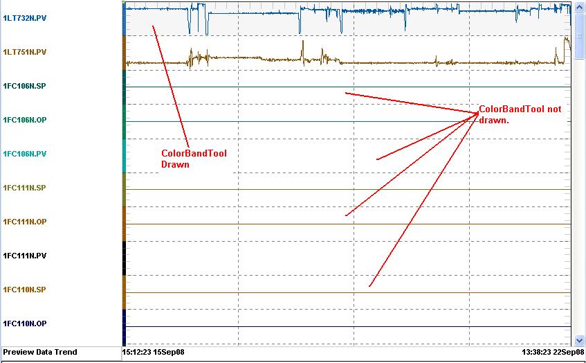

Your solution worked for me but i found another problem.
Out of 100 fastline series, for 50 series the high and low value are same. Means there is not data change.
In that scenario, the colorband tool is not getting drawn.
Is it a limitation in the color band tool? or i am doing something wrong?
Please let me how to solve this problem.
I am not able to use the rectangle tool because rectangle tool dont accept left, top, width and hight as float values.

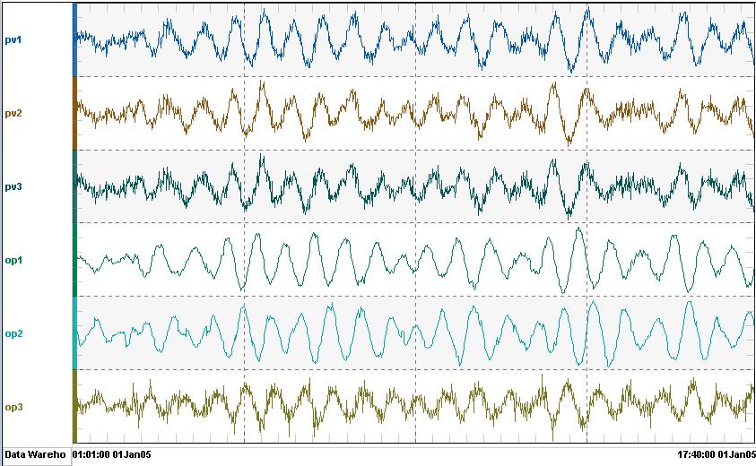

Yerey, Please see the images below. For the first image - ColorBandTools are drawn perfectly and alligned with the grid lines (this is very critical to be allingned with the grid line). In the second image you can see, for the series that dont have ny change in data, ColorBandTool is not drawn.
Imgae 1 :
Proper wiht ColorBand Tool
Image 2 :
Not Proper wiht ColorBand Tool

Post by Yeray » Thu Apr 22, 2010 12:02 pm
Hi Avijit,
I've incremented the number of series in the example I suggested above and, when the chart is too little to show to many series one below the other, the series are drawn like an horizontal line. But I'm still not sure that this is what you are experiencing. So, if that's not the same, could you please send us a simple example project we can run as-is to reproduce the problem here?
