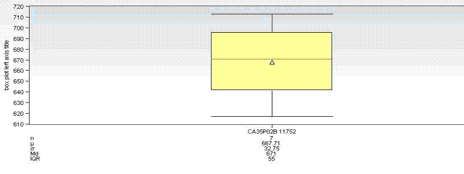

      // We use this line to change label angle to 90, but the chart does not reflect to this change
        tchart.Axes.Bottom.Labels.Angle = 90
End Sub
As you could see in the attached image, the box width is changed with the code, but the axis label angel is not changed.

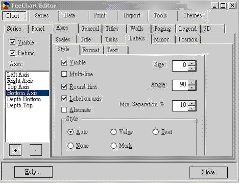

But we could see that the angel is changed to 90 in Chart Editor
angel in editor is changed.GIF (18.92 KiB) Viewed 7271 times
Please advise how could we eliminate this issue, thanks
Re: Bottom.Labels.Angle could not diretly reflect in chart
Post by Sandra » Tue Dec 29, 2009 10:00 am
Hello Chris. CHWU
I think that your problem occurs because chart needs redraw or refresh. Please see next code and check works correctly.
