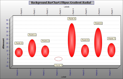

By the way, if I am using ellipse style and set gradient direction to FromCenter or Radial, than only those ellipses, which are above the origin line will be filled with colors, the others will be empty (same applies to horizontal bars)!
I could reproduce your problems using last version of TeeChart .Net. I have added these in bug list with numbers [TF02014764] and [TF02014766] We will try to fix these for next versions of TeeChart .Net.

Hello UserLs,
I inform that we’ve fixed the bug with number (TF02014766). Now works fine.
