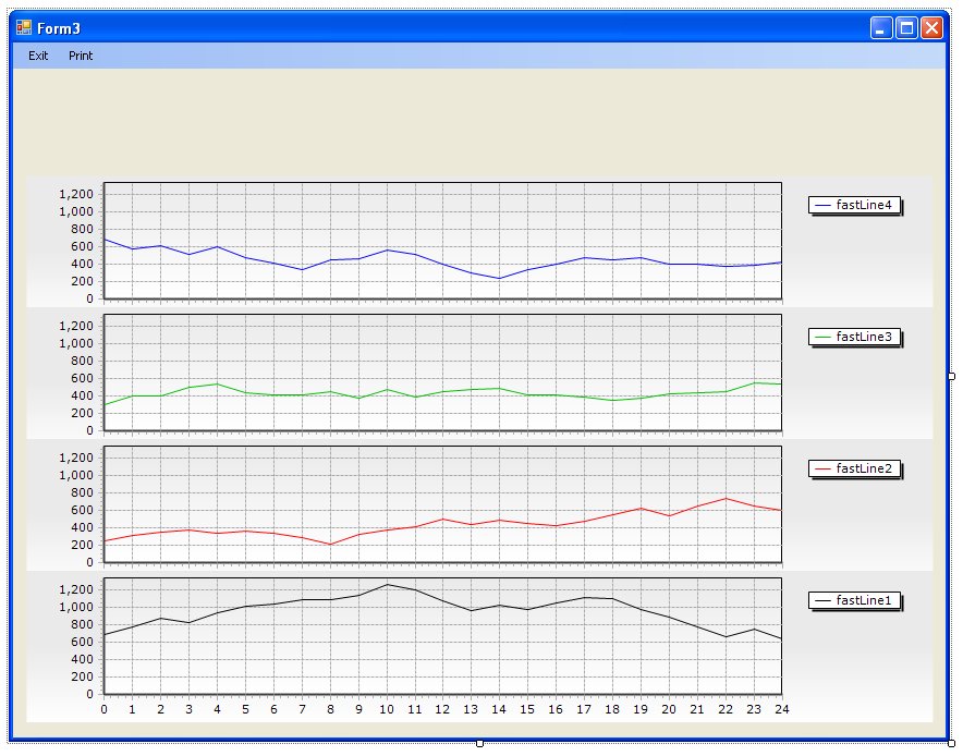

Can TChart produce a graph as a single entity as I have tried to simulate in the uploaded screen-shot?
Up to four (4) grids with individual Y-Axis' and 1 common X-Axis.
Any suggestions or input would be greatly appreciated!

Hello tirby,
I recommend that use custom axes. You could find examples in TeeChart .Net concretely in All Features\Welcome!\Axes and see Opaque zones example.
