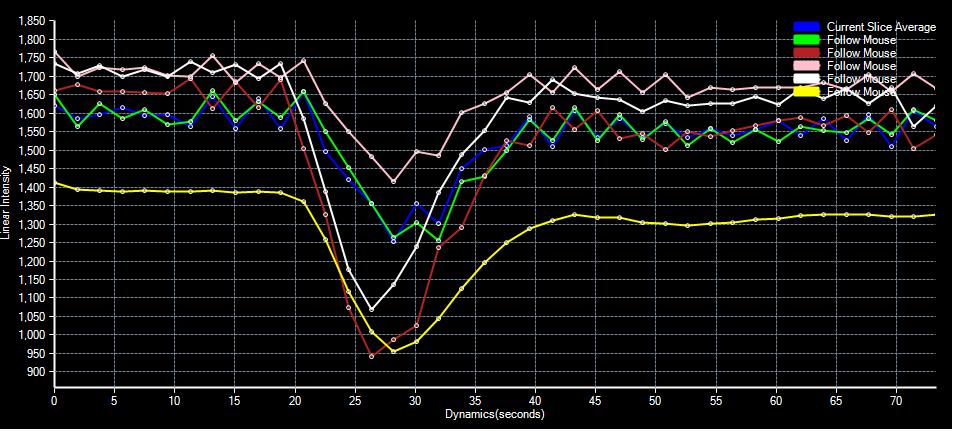

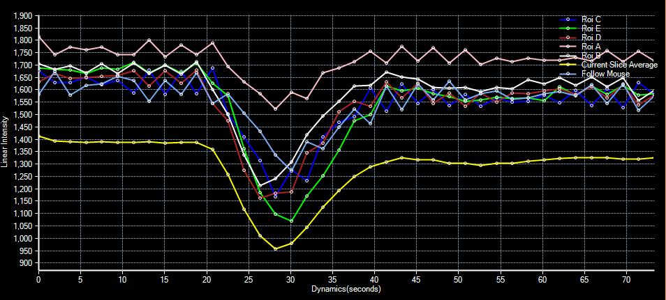

Attached is the snapshot of the tee-chart display before and after the patched tee-chart dll. There seems to be a problem with the display of legends.
The names and the display of legends have changed.
Could you please look into this issue?
Before change
After Change
Also, we are not sure of the changes done by you in this modified dll? Is it only unsigned vs signed or are there any other modifications?
Ideally we would prefer signed dll because changing from signed to unsigned would result in re-build of our component using the tee-chart.

PIC wrote:Attached is the snapshot of the tee-chart display before and after the patched tee-chart dll. There seems to be a problem with the display of legends.
It seems that the pointer HorizSize, VertSize and Style isn't applied to the Legend symbol. And it seems to have been broken from v4.0.2010.1350 to the actual sources. I've added it to the defect list to be revised asap (TF02014948).
Regarding the changes in the legend texts, could you please tell us how are you formatting the legend so we can reproduce the issue here?

We are trying to identify if the problem you've detected in your application (the 6-7 seconds lost at startup) is caused for the signature or not. If you still reproduce the problem with this x64 unsigned version, creating an v1 x64 version for you won't help us to identify the reason of the problem.
On the other hand, the problem with the legend symbols has already been identified and fixed (TF02014948).
