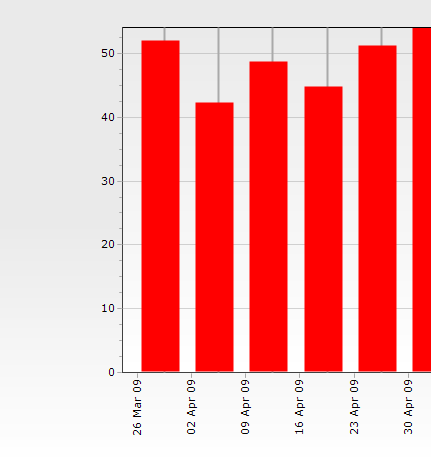

I have a chart that is plotting weekly summary data using a bar graph but I can'y get the x axis labels to line up properly. The data starts 29 Mar 2009 and ends 9 May 2010 in weekly increments, if I plot this data using a bar series I can the following.
21-05-2010 6-27-43 AM.png (12.83 KiB) Viewed 148954 times
As you can see the first label is 01 April 09, what I need is for the bar to have the correct label of 29 Mar 09 and for the label to be centered under the bar.
I've tried several different axis options but no matter what I try I can't get the labels to line up properly, If I increase the size of the chart (see next image) the labels change but still do not line up properly with the bars. Am I missing something here or is this a bug?

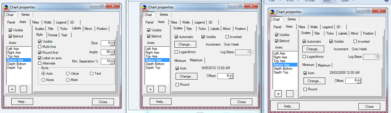

Here are sone screen shots of relevant properties pages
21-05-2010 6-42-11 AM.png (95.11 KiB) Viewed 148958 times
I'm using Tchart 4.0.2009.62330 in a VS2003 VB environment

One thing I've noticed that may be related is that I can't seem to change the Offset: value on the bottom axis, it is set to 8 and if I change it to say 0, when I view the axis properties again it is back at 8.

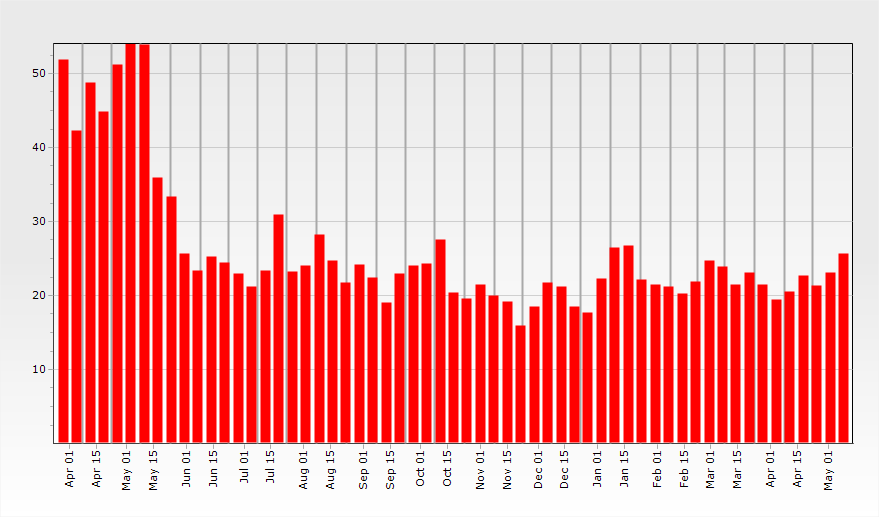

I'm not sure excatly which version this bug appeared in but it definately was not present in release 3.5.3146.24804.
25-05-2010 11-40-10.png (6.3 KiB) Viewed 148873 times

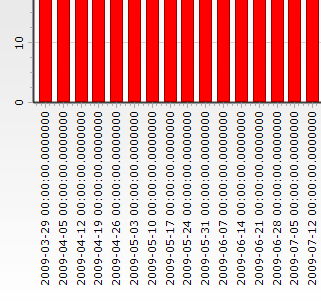

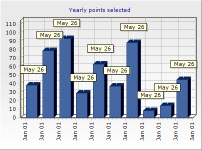

Ok, here is the code that reproduces the chart below using the latest released version of TChart:
            _testChart.Clear();
            var bar = new Bar(_testChart.Chart) {Marks = {Style = MarksStyles.XValue}};
            bar.XValues.DateTime = true;
            _testChart.Axes.Bottom.Labels.Angle = 90;
            _testChart.Axes.Bottom.Labels.DateTimeFormat = "MMM dd";
            _testChart.Axes.Bottom.Increment = Utils.GetDateTimeStep(DateTimeSteps.OneYear);
            var rnd = new Random();
            var date = DateTime.Now;
            for (var i = 0; i < 10; i++)
                bar.Add(date.AddYears(i), rnd.Next(100));
Note that bottom axis is set to automatic maximum and minimum, none of the points selected are from January, so the question is "Why January is showing up at all?" By setting increment to 365 instead of OneYear, setting Labels.RoundFirst to false and playing with axis Min/Max offsets I can get it to display the correct month (forget about dates!), but in my case it is not going to work, since my clients setup graphs using relative dates (year from today, 6 months from end of last month, etc.) and than print reports every month, or quarter without readjusting them ever after and expect to see the correct dates.

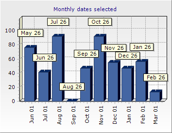

Here is similar problem with monthly dates:
            _testChart.Clear();
            _testChart.Axes.Bottom.Increment = Utils.GetDateTimeStep(DateTimeSteps.OneMonth);
                bar.Add(date.AddMonths(i), rnd.Next(100));

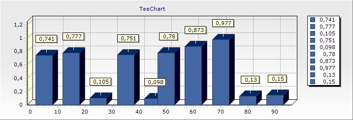

After studying the (TF02014914) issue, we concluded that (B) would be a designed behaviour rather than a bug. Let me explain:
The same happens with normal labels:
     tChart1.Series.Add(typeof(Bar));
     Random rnd = new Random();
     for (int i = 0; i < 50; i++)
       if (i % 5 == 0 && i % 10 != 0)
         tChart1[0].Add(i, rnd.NextDouble());
     tChart1.Axes.Bottom.Increment = 10;
If you don't specify where the labels should be drawn, we think one would expect them to be drawn at 0, 1, 2 etc, and if you set the increment to be 10, the labels should be at 0, 10, 20 etc. Where otherwise?

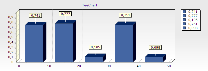

And furthermore, if you add more data, breaking the regularity:
            for (int i = 50; i < 100; i++)
                if (i % 10 == 0)
If we had changed axis labels to start drawing (5, 15, 25 etc.) they would now be "wrong" when new data added, right?
We could add a new property into axis labels (DrawAtPointValue or something similar) which would only draw labels on the axis where the series has a point. The problem will be that if there was a gap between one point and the next then there would be no axis labels. This is, in effect, identical to adding in point labels using the Series.Add overload.
