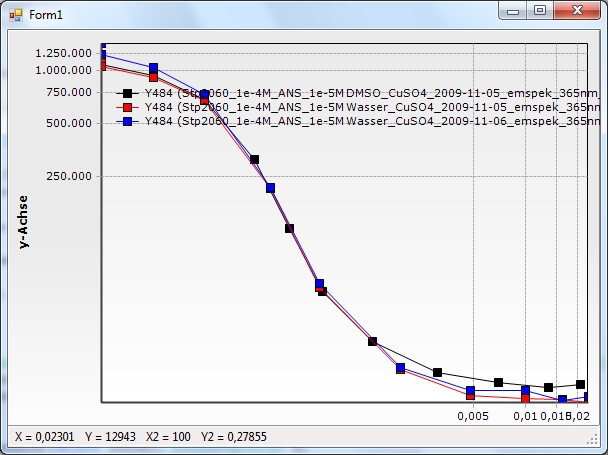

I must inform that the mentioned method calculates wrong values for logarithmic axes. My implementation is:
   Private Sub Chart1_MouseMove(ByVal sender As System.Object, ByVal e As System.Windows.Forms.MouseEventArgs) Handles Chart1.MouseMove
        Dim X, Y, X2, Y2 As Double
        Try
            If CursorTool1 IsNot Nothing Then
                X = CursorTool1.XValue
            Else
                X = Chart1.Axes.Bottom.CalcPosPoint(e.X)
            End If
            Y = Chart1.Axes.Left.CalcPosPoint(e.Y)
            X2 = Chart1.Axes.Top.CalcPosPoint(e.X)
            Y2 = Chart1.Axes.Right.CalcPosPoint(e.Y)
            Dim XX = X.ToString("G5")
            Dim YY = Y.ToString("G5")
            Dim XX2 = X2.ToString("G5")
            Dim YY2 = Y2.ToString("G5")
            MyMainForm1.StatusStrip.Items(0).Text = " X = " + XX
            MyMainForm1.StatusStrip.Items(1).Text = " Y = " + YY
            MyMainForm1.StatusStrip.Items(2).Text = " X2 = " + XX2
            MyMainForm1.StatusStrip.Items(3).Text = " Y2 = " + YY2
        Catch
            Dim i As Integer = 0
            For i = 0 To 3
                MyMainForm1.StatusStrip.Items(i).Text = " -"
            Next
        End Try
    End Sub
For instance, having the mouse over X = 0.005 the displayed value is "0.00014".

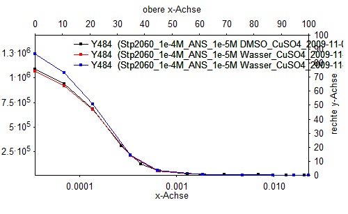

I just realized that the bug is much more engraving: The axis scaling is wrong, the CalcPosPoint method seems to be OK.
So the Logarithmic Scale Bug http://www.teechart.net/support/viewtop ... =4&t=11100 is also present in WinForms, not only in WPF.
The workaround in the above link works BUT:
- it's impossible to get appropriate axis labels (the series x values are between 0* and 0.023)
- it's impossible to convert to linear scale back
- after serialization/deserialization the error is there again
*x-axis minimum is at around 3e-5
This big bug makes it practically impossible for me to use TeeChart, logarithmic scales (and their conversion log <----> lin) are a must for me. My feeling is that axis scaling is such a basic feature of a chart component that it maust work under all circumstances!
Additionally, due to the other bugs discovered during the work on my application I wasted such an amount of time! Up to now, I used 3 sequenced releases of TeeChart, no one was bug free. Each of the two newer releases introduced new bugs concerning properties/features which I expected as basic for my application. They required a lot of work and time for workarounds which led to loss of functionality I primary introduced. And I have to ask me and you: When will the next release come? And will it again introduce new bugs questioning the usability of the charts?
It's extremely disappointing!

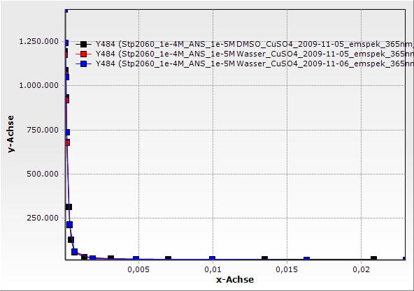

Please look at the chart and you will see that x-Axis labels are not appropriate, they overlap.
I expect an appearance as shown here:

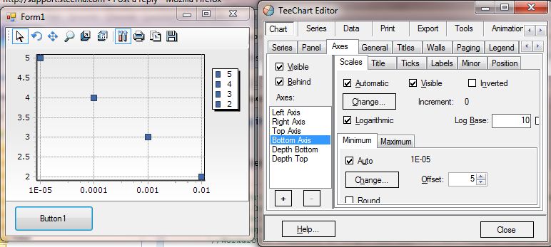

If you have the chart as shown in your last message then you could open the chart editor and convert the x axis back to linear scale: Nothing happens!
This works fine for me here as you can see in the image below. Setting a single axis to non-logarithmic also works fine for me here.
Is that what you expect?

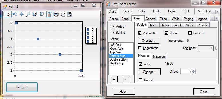

here is the code (Project contains only button, tchart and chart controller). Within this small sample the chart behaves different in comparison to my application but toggling between log and linear scale is still impossible.
    Private Sub Button1_Click(ByVal sender As System.Object, ByVal e As System.EventArgs) Handles Button1.Click
        'TChart1.Import.Template.Load("c:\test2.fxy")
        TChart1.Series.Clear()
        TChart1.Aspect.View3D = False
        '//Workaround suggested at http://www.teechart.net/support/viewtopic.php?f=4&t=11100#p47787
        TChart1.Axes.Bottom.Logarithmic = True
        TChart1.Axes.Bottom.Horizontal = TChart1.Axes.Bottom.Horizontal
        Dim Point As New Steema.TeeChart.Styles.Points(TChart1.Chart)
        For i As Integer = 2 To 5
            Point.Add(Math.Pow(10, -i), i)
        Next
    End Sub

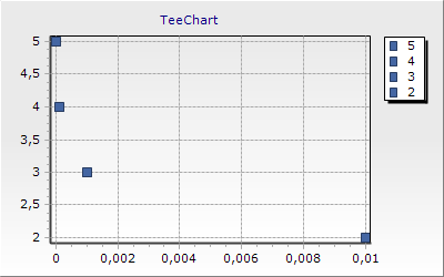

Here you can see the images when toggling the logarithmic property:
It should be very clear that the points must not be at the same positions!
Axis labeling seems to be also dependent from other things. In your mail from 07 Jul 2010 14:57 you got another labeling then I got with this example (x value range is comparable).
Best regards
Uli
Re: Bug in Axis.CalcPosPoint (log scales)
Post by Narcís » Thu Jul 08, 2010 9:42 am
Hi Uli,
This works fine for me here using the sources with the fix for TF02014882 as can be seen here:
This fix will be included in next maintenance release.

You were right, I changed the separators to my settings ("." and space). But by viewing the xml file I noticed that wrong data were in it, correct data you may find in the attached zip. In the original data (and that you can view in the "data" page of the chart editor) only one value has x=0. In your xml file i it seems to be that all data points with x<0.001 were set to x=0.
There is possibly a related phenomenon what I noticed sometimes in the last days nearby: If I set (in the chart editor) the axis increment to a value<0.001 then the axis editor displays "0" after closing the input box. Not sure that it is a general problem since I did not really work with the application (you know, why). Possibly this is related to the things we discuss here.
I did a further test with the synthetic data (see above): When I add a point with x=0 to the series no points were drawn.
When I then toggle between linear/log scale then some points were drawn but still wrong.
In this experiment axis were set to scale automatically. So possibly range checking is wrong: The chart should calculate the axis minimum on the basis of the smallest x > 0. In opposite to that synthetic sample the test2.fxy was imported from my old file format under applying the axis min/max values set in the old data file ("manual" scales). I checked my import class during data import: the axes.bottom.minimum was correctly set to 0.00003xxx. But in the chart editor the axis minimum is displayed as "0". According to the import autoscaling is disabled.
