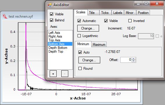

just found another bug in chart editor. It makes work extremly hard. The first image shows the initial state after showing the axis editor and selecting the x axis:

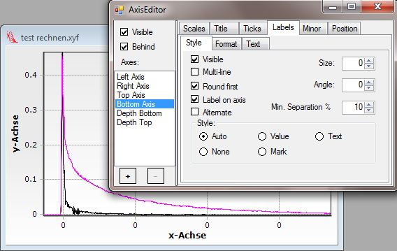

The following image represents the situation after only one click on the labels tab:
Obviously, by only changing the active tab page the formate string has been changed. That's terribly and highly confusing for the end user!

What I've reproduced and added to the defect list to be fixed in future releases (TF02015032) is the following:
With the code below, you can see something like when the application starts:
Then, if you open the editor and go to the Chart\Axes (Bottom Axis)\Labels, the bottom axis labels change to this:
