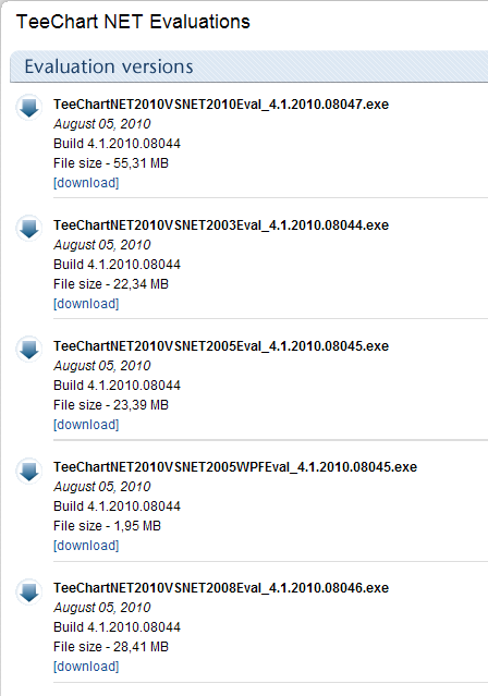

Yeray wrote:The installers that include the TeeChart.WPF.dll are the TeeChart for .NET v3 and up for Visual Studio .NET 2008 and up
First of all, I said that TeeChart.WPF.dll is included in the installers for Visual Studio .NET 2008 and up, but there is a TeeChart.WPF.dll for Visual Studio .NET 2005 too. But note that it is given in a separate installer because its possible to build WPF projects in Visual Studio .NET 2005 installing the Visual Studio 2005 extensions
Here it is the list of the latest evaluation installers:
All them, by default, install the library in the "TeeChart for .NET 2010 EVAL" folder, but only the following contain the TeeChart.WPF.dll:
- TeeChartNET2010VSNET2010Eval_4.1.2010.08047.exe
- TeeChartNET2010VSNET2005WPFEval_4.1.2010.08045.exe
- TeeChartNET2010VSNET2008Eval_4.1.2010.08046.exe
