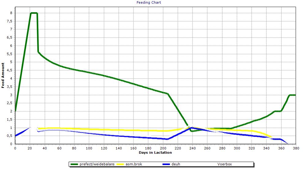

Hello i want to draw in my Graph four lines different color.when i write code, which is belove ,four lines look different color then i wrote as shown in picture.Especially white color looks very bad.Please could you help ,how i can draw different color lines?

Hi Solutions Gallery BV,
I think you are a little bit mistaken.
I see in your code that "series" is a Line series. Accessing to it's list you are accessing to the points of your series.
I understand you are trying to access to your chart series list, not your series point list, so you should do:
            tChart1.Series[0].Color = Color.Red;
            tChart1.Series[1].Color = Color.Purple;
            tChart1.Series[2].Color = Color.Black;
            tChart1.Series[3].Color = Color.Yellow;
Or also, the same:
            tChart1[0].Color = Color.Red;
            tChart1[1].Color = Color.Purple;
            tChart1[2].Color = Color.Black;
            tChart1[3].Color = Color.Yellow;

Hello Yeray
I tried the code which you wrote.But it gives error.Error is "System.ArgumentOutOfRangeException: Index was out of range. Must be non-negative and less than the size of the collection"

Hello Solutions Gallery BV,
I think that you need add your lines, previously change color for each lines. Please, try check again,our code using next lines:
            for (int i = 0; i < 4; i++)
                new Steema.TeeChart.Styles.Line(tChart1.Chart);
                tChart1[i].FillSampleValues();
                (tChart1[i] as Steema.TeeChart.Styles.Line).LinePen.Width = 5;
Could you say us, if previous code works as you want and is a good solution for your problem?
