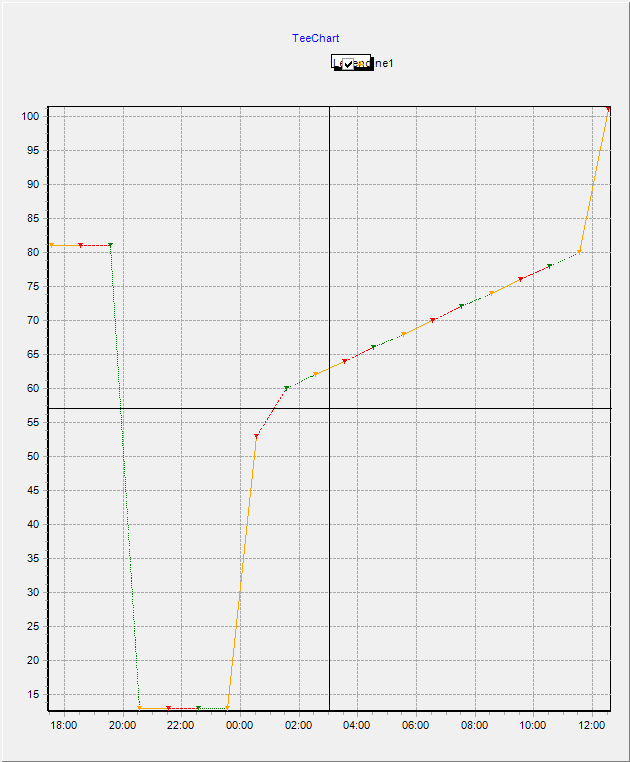

Thanks for the files. I found a bug in v3 and v4 which didn't let the series being painted which is that setting Legend.Text hides the series, for example:
            Steema.TeeChart.Styles.Line line1 = new Steema.TeeChart.Styles.Line(tChart1.Chart);
            line1.FillSampleValues();
            tChart1.Legend.Text = "legend";
This is a bug which I have added as a high-priority issue (TF02015257) to the defect list to be fixed. So in your project I had to comment in the line that set Legend.Text.

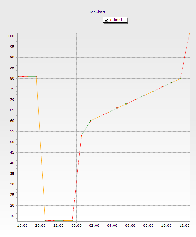

Having said that I got little bit different output in v3 and v2010 (aka v4) than in v2 where I get this:
While in v2010 I get this:
You'll notice line colours are shifted one position to the right. This is most likely due to the implementation of TF02012153 in v3 which I pointed you before. So in TeeChart 2010 you will have to tweak GetPointerStyle implementation a little bit to get what you have in v2.
Considering all that's been discussed here I think the simplest implementation and stabler solution is using a custom series as in the example I wrote.
