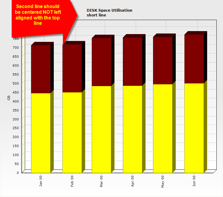

If i create a two line centered chart title where one line is longer than the other the two lines don't center properly, see the example below.
14-11-2010 10-16-07.png (26.75 KiB) Viewed 8887 times

Hello Adrian,
I couldn't reproduce your problem using last version of TeeChart.Net and next code:
            Steema.TeeChart.Styles.Line series1 = new Steema.TeeChart.Styles.Line(tChart1.Chart);
            series1.FillSampleValues();
            tChart1.Header.Text = "My two lines \n title";
            tChart1.Header.TextAlign = StringAlignment.Center;
Could you check, if previous code works for you? On the other hand, could you tell us what version of TeeChart are you using?

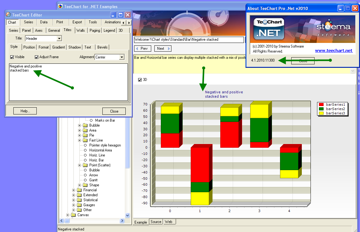

I've just downloaded the latest release 4.1.2010.11300 and using your Feature demo from that release goto Welcome !\Chart styles\Standard\Bar\Negative stacked. It illustrates the issue.

Post by Sandra » Wed Dec 22, 2010 10:07 am
Hello Captell,
I added your request in wish-list with number [TF02015333] to be considered inclusion it in next versions of TeeChart.Net. At the moment, you can use a solution I suggest previously, that modify alignment in the code.
