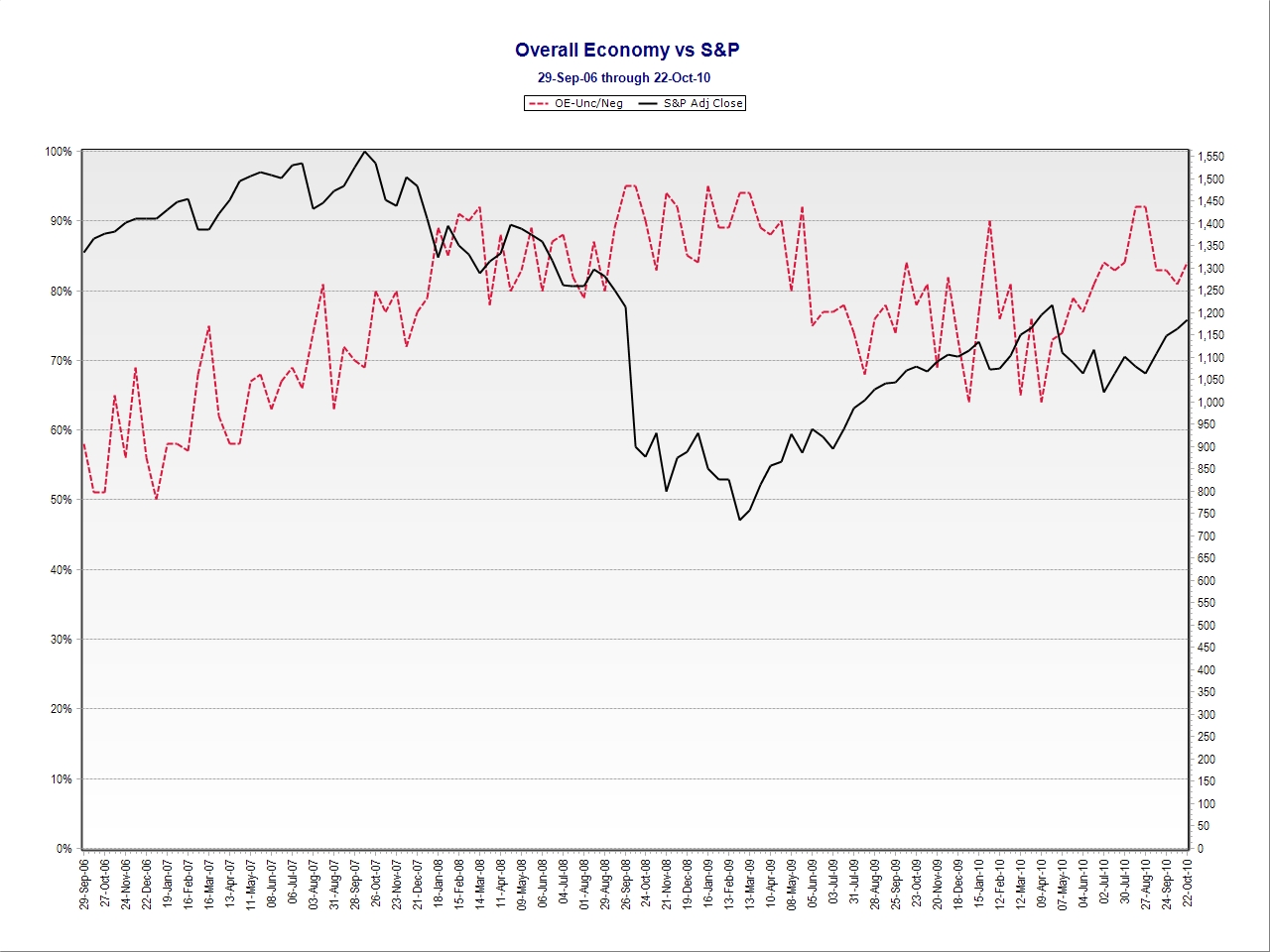

I need for the background color of the actual chart area to be white. Setting tchart1.BackColor = Color.White sets the background color of the panel to white but the background of the chart interior remains an off-white. How can I get the interior of the chart to be white?

No, that doesn't work. Attached is a sample of the current output.

Hi tcorrigan5,
You need to do the same with Walls.Back as you did with Panel:
            tChart1.Walls.Back.Color = Color.White;
            tChart1.Walls.Back.Gradient.Visible = false;
Or alternatively set back wall to be transparent:
            tChart1.Panel.Color = Color.White;
            tChart1.Panel.Gradient.Visible = false;
            tChart1.Walls.Back.Transparent = true;

Post by tcorrigan5 » Tue Nov 16, 2010 5:08 pm
Yes, that works. Thank you.
