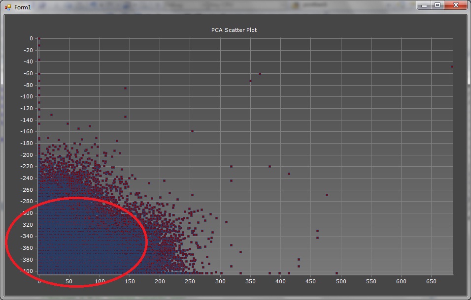

Hello Dave,
Loading your chart1.ten and using last version 3 of TeeChart.Net, I get next image: You can see I have drawn a red circle where there is condensed points area. Can you confirm us; if problem you mean is area where there is circle?
If it is your problem, is produced because you are drawing many points in this section or your chart and these are condensed. For solves this, I suggest two options:
First: Make the pointer of points smaller so you can see more points.
Second: Does the chart biggest to see the points.
Otherwise, if in the image doesn’t appear your problem please explain exactly how we can reproduce it.

Sandra yes you have circled the correct area.
I tried making the points smaller but the chart doesn't look very good. Also expanding the chart doesn't help much.
Im going to try and play around with the chart editor settings and see if I can make the chart look better. Thanks for your help.
