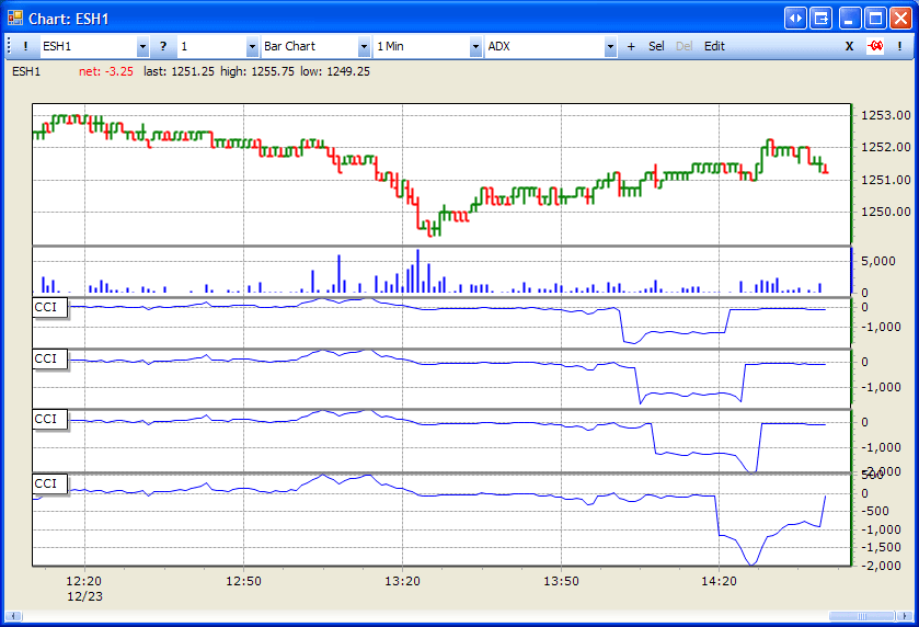

I have a basic chart going with an OHLC candle series and volume. If I add a pane with a CCI study in it I always get some odd lines at the end of the CCI chart. Following is a good example. You can see 4 CCI studies. They are all created identically with the period set to 20, the datasource set to Candel1, and the datamember set to "Close". The difference between the charts is when they were created. Each chart was added to the overall chart a few minutes after the previous one. Notice the big drop that occurs in each chart. As time goes by that drop changes in its position.
[img]
CCI image
[/img]
The code that was used to create it is:

Can you confirm that the CCI function is drawing properly? Or, if there is something incorrect about the way I create it, please let me know.

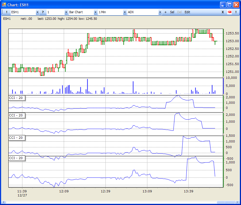

I thought the issue was resolved, but it is not. I am not sure if it has to do with the number of data points or what. I have attached a spread sheet showing the data loaded into the chart (image below). The chart has 4 panes with 20-period CCI charts in them. A single block of code created each chart. The only difference is that they were each added to the chart a few minutes apart.
The attached zip file contains a spreadsheet with the original data from the chart you see below, and it contains a VB.Net form for a window with a TEEChart control on it and two buttons. One button will load data from a text file (which is inside the zip file) and will display a bar chart and CCI chart. You will see the spike in the last 20 bars of the chart if you run that code.
You can see in the spreadsheet for the data from the original image, that the data for each is identical up to the point where the most recent data is about 40 bars from the end of the chart. If you create one CCI chart, wait a few minutes and then create another CCI chart with the same settings, you see the strange data move a bit further down. It is always 40 bars from the end of the data.
I beleive that 40 number has something to do with the 20 period setting. In the most recent (bottom) CCI study added, at the end of the stream of data you see 20 blank datapoints, preceded by one bar (which one new data coming in before I could export the chart data), and that preceded by 20 bars of, basically, bad CCI calculations. Notice that the bad CCI points are always the last 20 in the chart at the time that they are added.

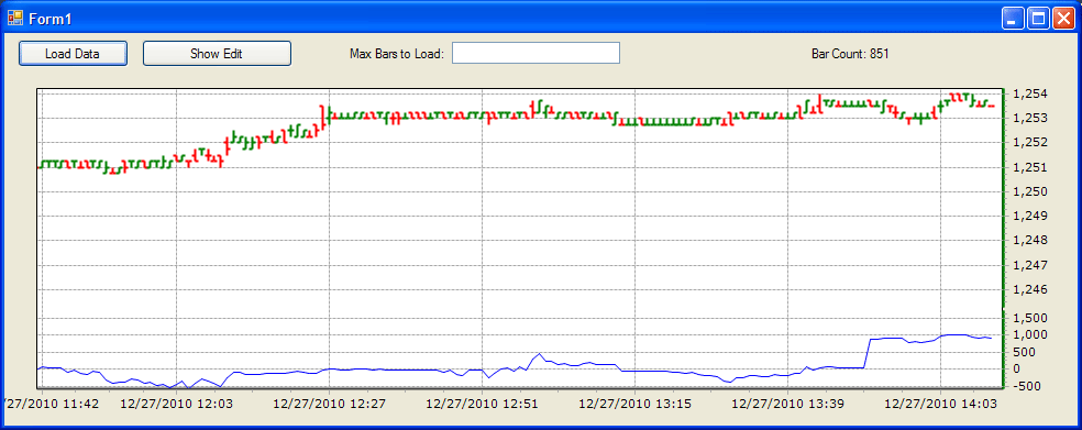

I have attached a new code project here. It uses the latest 2010 TeeChart version, and was created by VS2010. The file also includes actual data from yesterday for the March 2011 ES contract in a file called ChartData.txt. When you load data, please use that data so we can see the same things. I suspect that if you use less data the problem may not be apparent. The zip file also contains the .GIF images that are attached to this message.

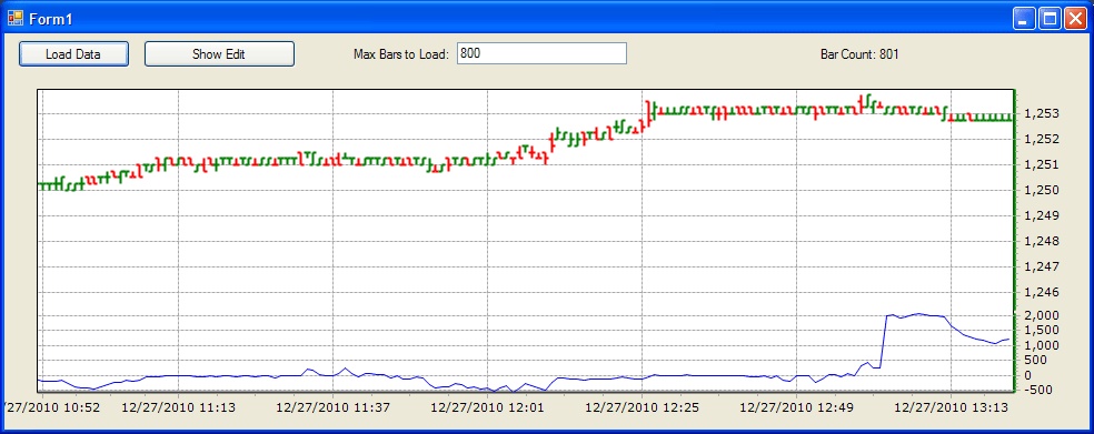

I think I can demonstrate exactly what I am referring to here with the CCI function. The sample project now lets you tell it how many bars to load. If I select 800 bars, I see the following results:
First Chart
Notice that the CCI spikes at apporoximately 13:02 on this chart.
Now we recreate the chart, loading more data from the same file. The data in this next chart is identical to the data in the first chart, except that there are about 50 more bars on the end.
Chart 2
The CCI study no longer has a spike as 13:13. It is calculating the CCI properly at that point in time. The spike now appears at 13:52. The spike has shifted over the same number of bars that were added to the chart. If I load 730 bars from this file, the CCI looks like it could be correct. If I load 750 bars, or more, I see the spike. (Perhaps there is a critical point somewhere there.)
Here is another quirk. If I load 600 bars of data, the TeeChart control throws an error "Index was outside the bounds of the array" on the line of code where I set Line1.YValues.DataMember = "Close". If I coment that out, 600 bars loads fine. If I attempt to load 750 bars with that commented out, I get the same error at the "PeriodAlign =" line. If I uncomment the line, it loads 750 bars fine. I would not be surprised if the issue here has to do with the amount of data loaded.

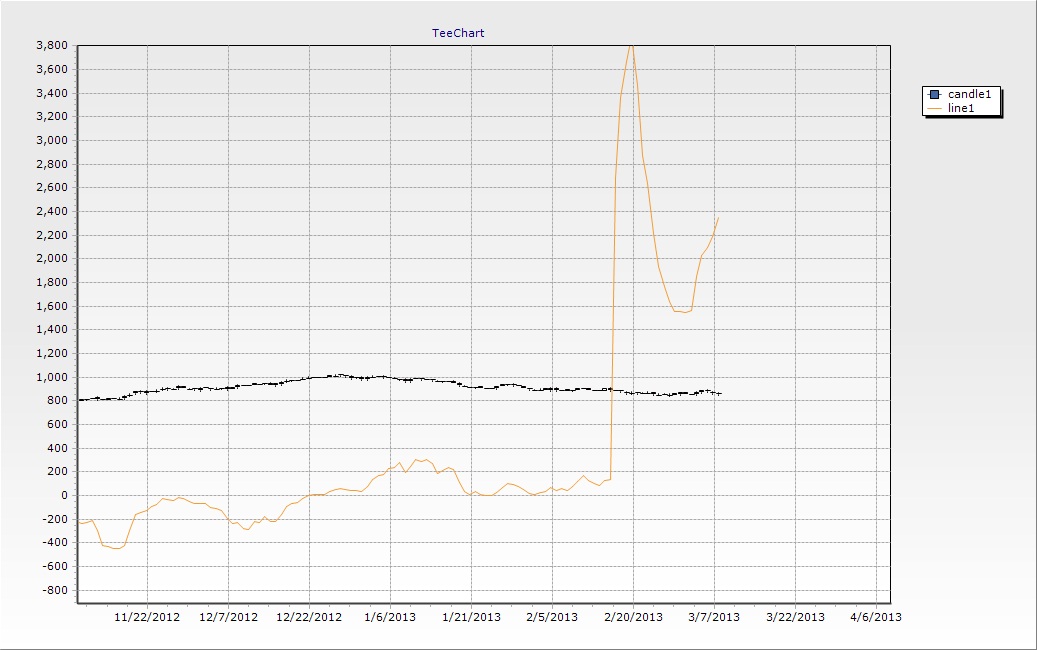

We have reproduced your problem using next simple code:
            tChart1.Series.Clear();
            tChart1.Page.MaxPointsPerPage = 150;
            Steema.TeeChart.Styles.Candle CandleSeries1 = new Steema.TeeChart.Styles.Candle(tChart1.Chart);
            //CandleSeries
            CandleSeries1.TreatNulls = Steema.TeeChart.Styles.TreatNullsStyle.Ignore;
            CandleSeries1.FillSampleValues(800);
            //Function CCI
            Steema.TeeChart.Styles.Line line1 = new Steema.TeeChart.Styles.Line(tChart1.Chart);
            Steema.TeeChart.Functions.CCIFunction CCI1 = new Steema.TeeChart.Functions.CCIFunction();
            line1.Function = CCI1;
            line1.DataSource = CandleSeries1;
            line1.Function.Period = 20;
            line1.Function.PeriodAlign = Steema.TeeChart.Functions.PeriodAligns.Last;
            line1.Function.PeriodStyle = Steema.TeeChart.Functions.PeriodStyles.NumPoints;
            line1.TreatNulls = Steema.TeeChart.Styles.TreatNullsStyle.DoNotPaint;
And we have gotten next results:

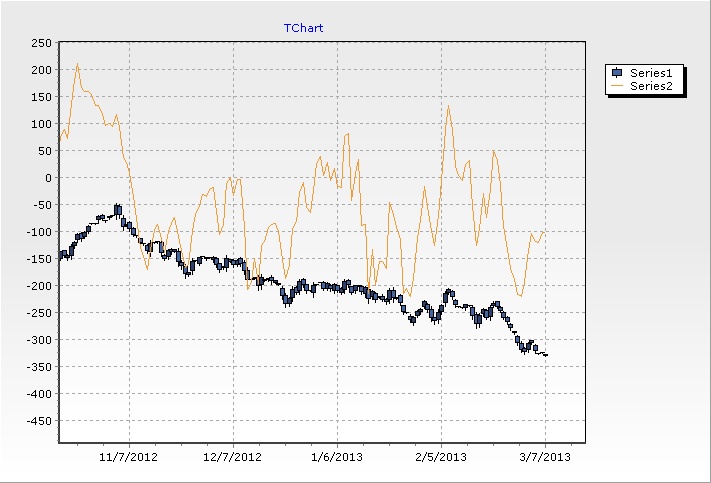

I have made same test, using same code in TeeChartVCL and we have gotten next results:
Data that have generated this images, in both cases are:
VCLNetData.zip
(52.21 KiB) Downloaded 331 times
We think that in VCL code, function CCI works as expected. Could you confirm us, if you believe that function in VCL code is correct? So we can try to modify code of .Net CCI function for code VCL CCI function.
