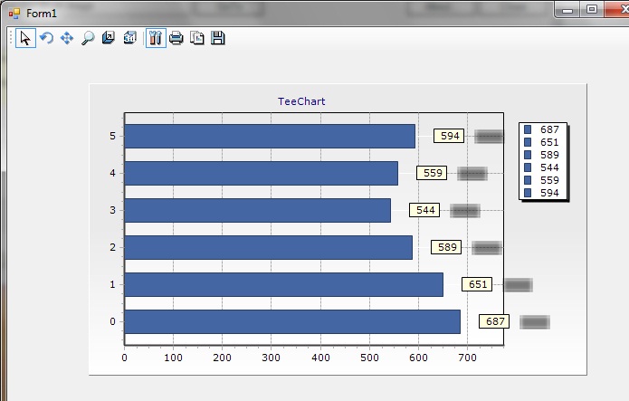

a. Setting Smooth to true has unpredictable results. The position may or may not change, the shape of a shadow itself in some cases looks like a piece was cut off (even though there is plenty of room to finish its drawing), the edges (the default - I did not play with any settings) look completely different from the older version I was using (last time I upgraded was June 2010 version). It is absolutely unacceptable for our users.
Could you confirm us if your problem with shadows appears in the shadow marks of there is in the next image:
