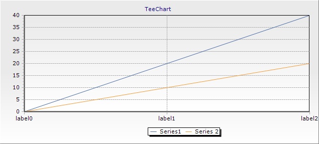

I couldn't reproduce your problem using last maintenance release and your example code, and all labels appears in my chart as you can see in next image:
Could you tell us which version of TeeChart are you using?
