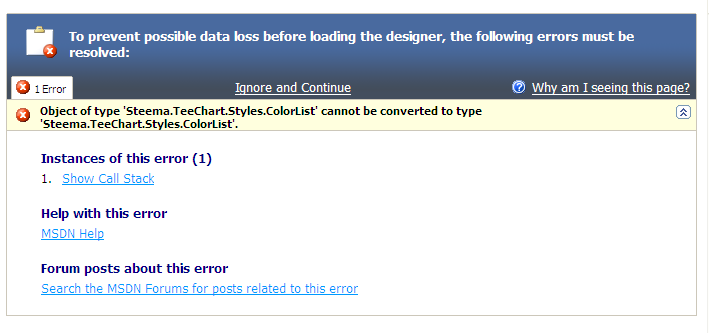

Object of type 'Steema.TeeChart.Styles.ColorList' cannot be converted to type 'Steema.TeeChart.Styles.ColorList'.
I'm using Visual Studio 2008 sp 1.
Targeting .Net framework 3.5

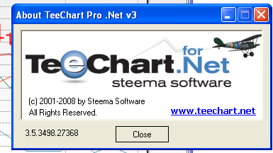

And usine TChart .Net v3 see attached version screenshot.

Error opening form with TChart on it.

I found the solution.
This project used to reference an old version of teechart.
And even though I changed the reference to the new teechart.dll in the project --
When I created a new project from scratch and added the new teechart to it I noticed that in the vbproj file the references were not the same as in the old project.
So I copied the new reference by hand from the new project to the old project and that solved this problem.
