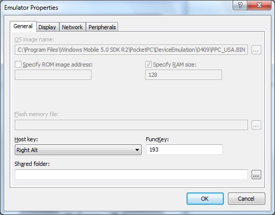

I have been running your code here for about 10 minutes without problems. I'm using Visual Studio 2008 with built-in USA Windows Mobile 5.0 Pocket PC R2 Emulator. Garbage collector seems to do its job with DeviceEmulator.exe. It uses 128 MB RAM:
Which environment are you using? Do you use a device or an emulator? How much memory does it use? Can you reproduce this using an emulator? During how many time do you have to run the app?
