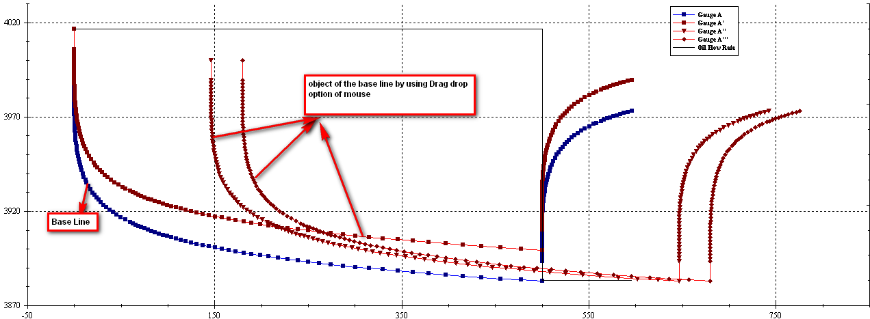

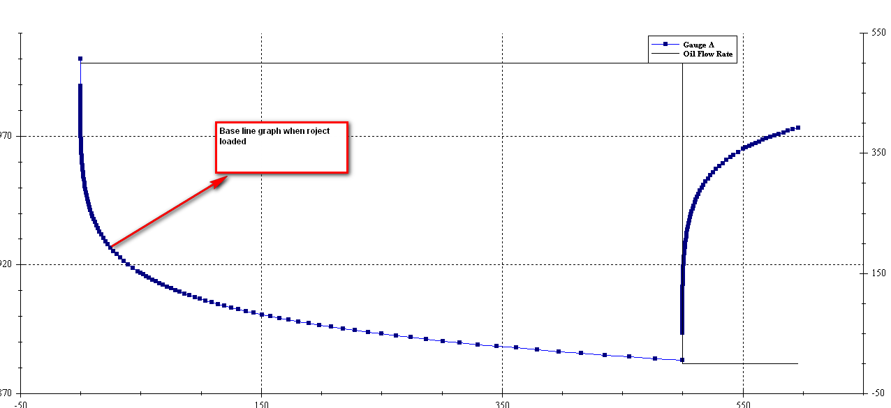

Problem is attached in screen shot please look this.
thanks
Sudhir
thanks
Sudhir
- this is base graph when project would load
- second.PNG (35.18 KiB) Viewed 11917 times
- drag multiple line object from the base line
- baseGrap1.PNG (18.76 KiB) Viewed 11916 times

The project is in initial stage so this is first graph which i have to plot, actually i have taken a line object to draw the base graph and this would load at the time of project loaded then i have to drag this line using mouse and drop it on the teechart then a new line objeect would be created which is mentiond in attached screen shot.
