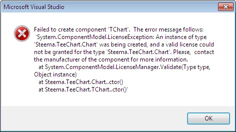

I am facing a problem after migrating my project from Evaluation version (TeeChartNET2010VSNET2005Eval_4.1.2011.04195) to Licensed version (TeeChartNET2010VSNET2008_4.1.2011.04192). The problem is, after adding TeeChart on toolbox when I drag and drop tChart control on my form it through an exception as in following snap. This problem also comes with new project.
I have also uninstalled Evaluation version from my system but still there is same problem. Please tell me if I am doing anything wrong.

Seems there is a problem with components of Teechart that you have in toolbox and new version of TeeChart.dll .I recommend remove the all of components of TeeChart you have in toolbox of VS2008 and after do next:
  • -Create a new tab of TeeChart.Net
    -Click with button right
    -Select choose items
    -Click in Browse Button
    -Select the TeeChart.dll of folder where you have installed TeeChart.Net for example: "C:\Program Files\Steema Software\TeeChart for .NET 2010 VS2008\TeeChart for .NET 2010"
    - Click in button Ok and try again, if your problem of license is solved.

Thanks for the reply. Well! I did the same process as you mention in your post for adding TChart in toolbox. But I was making a mistake without installing this I was using its dll directly.
Now this issue is resolved as I have installed licensed version on my system. It is working fine. :)
