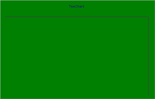

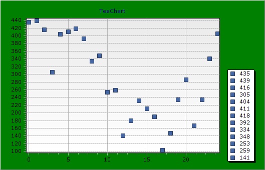

Image Walls.Visible=true:
Image Walls.Visible=false: To genereted this image I have use next code:
Please check previous code if works as you expected? If isn't work as you want please explain exactly why you think that walls are visible so we can try to help you to solve it.
You need know that Walls Right, for default isn't visible, so property Walls work fine as you can see i next image, where I have changed the color of Chart Panel and I have set the walls as not visible:I want to clear every thing I set on graph by using following code

If you want change Position Offset% of legend to run time you need change value of property TopLeftPos as do in following line of code:Question.02.
How can I access/alter following property on run time
TeeChartEditor-->Legend-->Position-->Position Offset %.
Hope you understand above hierarchy , I provide print shot of exact screen as well.
tChart1.Legend.TopLeftPos=40

Re: TChart1.Walls.Visible and Position Offset %
Hello Maverick,
If you can need set axes property visible = false as do in following line of code:
Can you tell us if previous line of code works as you want?
tChart1.Axes.Visible = false;
Sandra,
Bundle of Thanks.
Hmmm...Yes it works and it means the right and top lines left, are part of Axis not walls.
