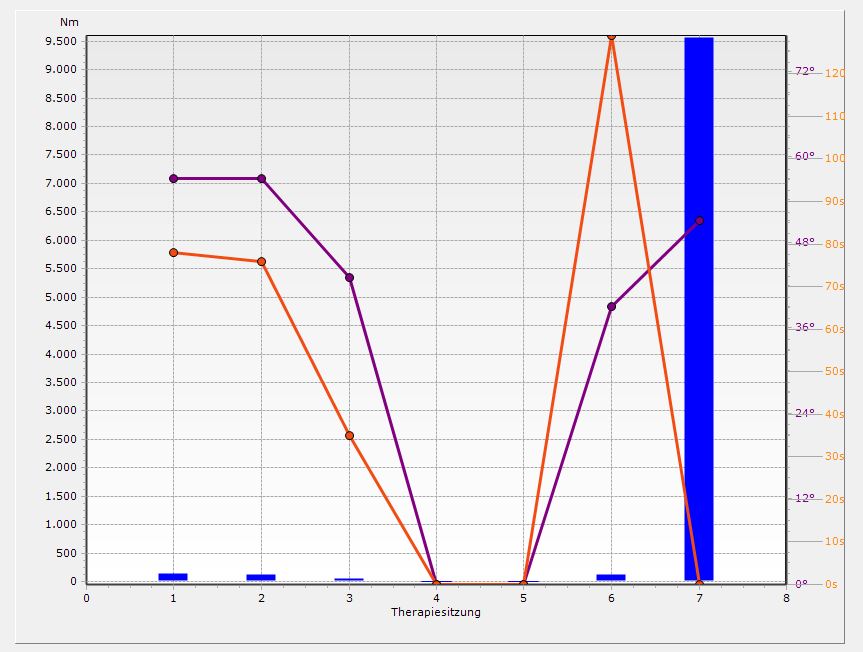

I added a custom axis, thanks for your advice. If have two more questions:
Is there a way, that I can show the orange Labels inside the Chart?
At the moment I moved the labels to the right by setting the axis1.Ticks.Length to 35. How can I make moving to the left into the chart? (see attchement)
When I make the cusom axis1 visible, the Tchart1 dosn't automaticly become smaller to show the full lables (like it does with tChart1.Axes.Right). As you see on the pictures (see attchement), the orange lables from the axis1 are cut off a little bit.

Additional information:
When I make the tChart1.Axes.Right.Visible = false (the violett axis), the chart resizes automaticly and becomes bigger and the the orange (the custom axis) is outside the picture

Hola
I found the solution:
with Axis.Positon.Position = xx% I can the position of the axis to any point
And because I have the labels inside the chart now (at 100%, but "Other side" not selected) I don't have the problem any more, that the labels are outside the tChart image. !!
Hasta luego
Eric
