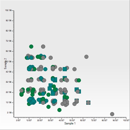

If I set a manual scale, say 0 to 100 for x and y axes, the Y Axis Title overlaps on the Y Axis Labels. Auto scale works OK.

I am able to fix the problem by setting:
Points1.Chart.Axes.Bottom.Labels.RoundFirstLabel = True
Points1.Chart.Axes.Right.Labels.RoundFirstLabel = True
Points1.Chart.Axes.Left.Labels.RoundFirstLabel = True
Points1.Chart.Axes.Top.Labels.RoundFirstLabel = True
