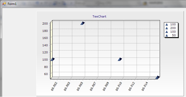

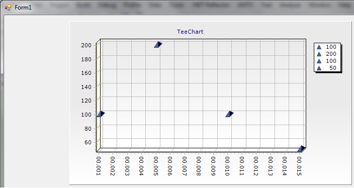

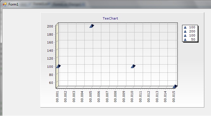

And I have gotten, changing the angle of labels, next results :
Angle=90:
Angle=270:
Angle=60:
Can you tell us if previous code works as you expected and image show the result as you want?

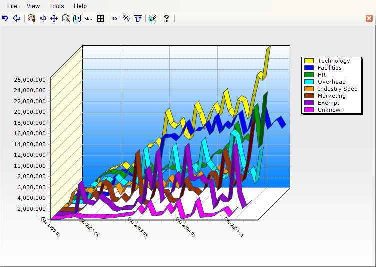

I now see how how the angle property affects the label rotation. But now, when I rotate my labels to the desired angle, they overlap the chart. I've tried using the Labels.Top property to move them, but there doesn't seem to be any affect. Please see the attachment.
Matt
New Bitmap Image.png (105.25 KiB) Viewed 7839 times

Post by Sandra » Wed Sep 21, 2011 2:50 pm
Hello Matt,
Thank you for image. I can reproduce your problem using last version of TeeChart.Net and I have added your request in the bug list report with number [TF02015749]. We will try to fix it for next maintenance releases of TeeChart.Net.
