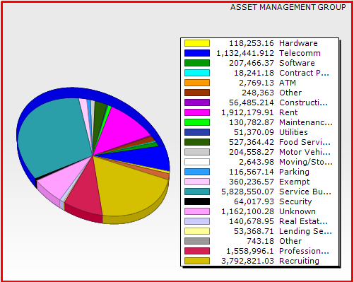

Hi:
Please have a look at this pie chart. There appears to be a rendering issue. Using the z-depth tool has no effect. Using the rotation tool, I can make the ugliness disappear using the rotation tool, but I can also make reappear by continuing to play with the rotation.
I'm using version 4.1.2010.8042
Any ideas?
Matt
Any ideas?
Matt

Hello biqpaulson,
I couldn't reproduce your problem using last version of TeeChart.Net. I recommend you update your version to last release of TeeChart.Net 2011. You can download the version in the custom download page. When you have the last version of TeeChart.Net, please check again if your problem persists. If you have any problems to update your version or your problem still appears in the last release, would be very helpful for us, if you can arrange a simple project, so we can reproduce exactly your problem here.

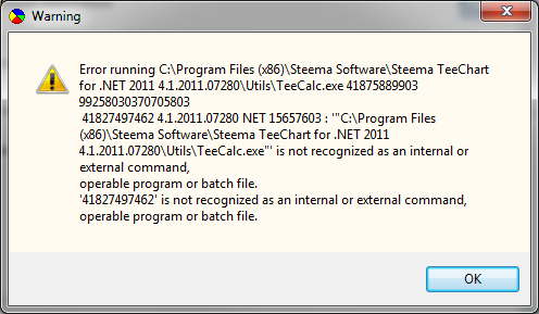

I tried to follow your instructions. Now (this is different than the first time I installed), I received the following message (see attachment).
Matt
Matt

Re: Strange look pie charts
Hello Matt,
It occurs when you reinstall the version without uninstalling your previous installation, because to default, installer always, suggest same path and same folder to install all of IDEs. I suggest you, two ways to solve the problem:
1.- Uninstall the TeeChart.Net and remove the folder where it was installed.
2.- Change the name of folder for example, if you want install different IDES you can set names:
Steema TeeChart for .NET 2011 4.1.2011.07280 VS2010
Steema TeeChart for .NET 2011 4.1.2011.07280 VS2008
Steema TeeChart for .NET 2011 4.1.2011.07280 VS2005
Steema TeeChart for .NET 2011 4.1.2011.07280 VS2003

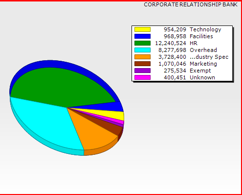

After dropping the old teechart reference and adding the "new" (3.5) reference, the test project complied correctly.
I then updated my product references and ran the pie chart test again using the newer version of your product.
Unfortunately, the pie-chart rendering issue still occurs.
Regarding the rendering issue, I have noticed the following:
If you create a "larger" pie chart and then use the rotate tool to force the rendering problem to occur, it will not.
If you create a "smaller" pie chart and then use the rotate tool force the rendering problem to occur, the "bad" render will come and go as the rotation angel changes.
It will be difficult for us to create a repro in a small project for you, but we will try. In the mean time, can you also try to create a smaller pie chart and then use the rotation tool to see if you can cause the rendering problem? It seems to me that my bad pie chart is around 200x200 pixels (see attached).
Matt
I was able to install your newest build but choose "vs2008" as the target and it did create the 3.5 framework directory (I can see why you structured the installer this way, but I would suggest clarifying the screen on the installer to make this more obvious -- like adding: "VS2008 (.net framework 3.5, etc.
Matt
- BadPie1.png (21.07 KiB) Viewed 17400 times
Hello Matt,
Finally, I can reproduce your problem and I have added it in bug list report with number [TF02015753]. We will try to fix it for next maintenance releases of TeeChart.Net
