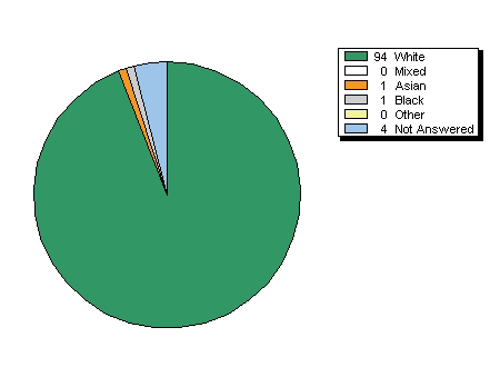

2 Questions on the pie charge sample attached,
1. how can I add the % symbol next to the figure
My code is:-
pie.Add(Convert.ToInt32(ethnicperc1), "White", Color.FromArgb(49, 151, 101));
pie.Add(Convert.ToInt32(ethnicperc2), "Mixed", Color.FromArgb(255, 255, 255));
pie.Add(Convert.ToInt32(ethnicperc3), "Asian", Color.FromArgb(245, 152, 31));
pie.Add(Convert.ToInt32(ethnicperc4), "Black", Color.FromArgb(205, 205, 205));
pie.Add(Convert.ToInt32(ethnicperc5), "Other" , Color.FromArgb(244, 243, 160));
pie.Add(Convert.ToInt32(ethnicperc6), "Not Answered", Color.FromArgb(157, 197, 233));
pie.Rotate(90);
2. The pie appears to be generated anticlockwise, is there a way of make it clockwise
My code is:-
pie.Rotate(90);
- RTE_488_Ethnic.jpg (44.3 KiB) Viewed 46624 times

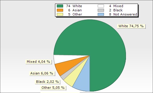

Hello MikeTheLad,
For example:
You need use property Style of Marks as do in next simple code:1. how can I add the % symbol next to the figure
Steema.TeeChart.Styles.Pie pie = new Steema.TeeChart.Styles.Pie(tChart1.Chart);
tChart1.Legend.Visible = true;
tChart1.Header.Text = "";
pie.Circled = true;
tChart1.Chart.Panel.Color = System.Drawing.Color.White;
tChart1.Chart.Panel.Bevel.Outer = Steema.TeeChart.Drawing.BevelStyles.None;
tChart1.Chart.Panel.Bevel.Inner = Steema.TeeChart.Drawing.BevelStyles.None;
Random rnd = new Random();
int ethnicperc1, ethnicperc2, ethnicperc3, ethnicperc4, ethnicperc5, ethnicperc6;
ethnicperc1 = 74;
ethnicperc2 = 4;
ethnicperc3 = 6;
ethnicperc4 = 2;
ethnicperc5 = 5;
ethnicperc6 = 8;
pie.Marks.Style = MarksStyles.LabelPercent;
pie.CustomXRadius = 120;
pie.CustomYRadius = 120;
pie.Add(ethnicperc1, "White", Color.FromArgb(49, 151, 101));
pie.Add(ethnicperc2, "Mixed", Color.FromArgb(255, 255, 255));
pie.Add(ethnicperc3, "Asian", Color.FromArgb(245, 152, 31));
pie.Add(ethnicperc4, "Black", Color.FromArgb(205, 205, 205));
pie.Add(ethnicperc5, "Other", Color.FromArgb(244, 243, 160));
pie.Add(ethnicperc6, "Not Answered", Color.FromArgb(157, 197, 233));
pie.Rotate(180);
I recommend you change the angle of rotation to achieve make the pie as clockwise.2. The pie appears to be generated anticlockwise, is there a way of make it clockwise
For example:
pie.Rotate(180);

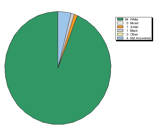

The % symbol I require on the legend next the figures, but not on the graph.
I have created in Phtoshop what I require the pie to look like
- RTE_488_Ethnic_Flipped.jpg (27.62 KiB) Viewed 46552 times
Re: Pie Charts
Hello MikeTheLad,
Ok. Seems finally I have understood you want achieve. I have made a simple code where used an auxiliary pie series to save the originaly values and other series to manipulate values. Please see next code and check if works as you want:
Steema.TeeChart.Styles.Pie pie1, pieaux;
tChart2.Aspect.View3D = false;
pieaux = new Steema.TeeChart.Styles.Pie();
pie1 = new Steema.TeeChart.Styles.Pie(tChart2.Chart);
tChart2.Header.Text = "";
tChart2.Chart.Panel.Color = System.Drawing.Color.White;
tChart2.Chart.Panel.Bevel.Outer = Steema.TeeChart.Drawing.BevelStyles.None;
tChart2.Chart.Panel.Bevel.Inner = Steema.TeeChart.Drawing.BevelStyles.None;
ethnicperc1 = 94;
ethnicperc2 = 0;
ethnicperc3 = 1;
ethnicperc4 = 1;
ethnicperc5 = 0;
ethnicperc6 = 4;
// Save Originaly values.
pieaux.Add(ethnicperc1, "White", Color.FromArgb(49, 151, 101));
pieaux.Add(ethnicperc2, "Mixted", Color.FromArgb(255, 255, 255));//white
pieaux.Add(ethnicperc3, "Asian", Color.FromArgb(245, 152, 31));//Orange
pieaux.Add(ethnicperc4, "Black", Color.FromArgb(205, 205, 205));//Grey
pieaux.Add(ethnicperc5, "Other", Color.FromArgb(244, 243, 160));//Yellow
pieaux.Add(ethnicperc6, "Not Answered", Color.FromArgb(157, 197, 233));//blue skye
//Add values
pie1.Add(pieaux.YValues[5], pieaux.Labels[5], pieaux.Colors[5]);
pie1.Add(pieaux.YValues[4], pieaux.Labels[4], pieaux.Colors[4]);
pie1.Add(pieaux.YValues[3], pieaux.Labels[3], pieaux.Colors[3]);
pie1.Add(pieaux.YValues[2], pieaux.Labels[2], pieaux.Colors[2]);
pie1.Add(pieaux.YValues[1], pieaux.Labels[1], pieaux.Colors[1]);
pie1.Add(pieaux.YValues[0], pieaux.Labels[0], pieaux.Colors[0]);
pie1.Rotate(90);
tChart2.Legend.Inverted = true;
pie1.Marks.Visible = false;
pie1.Marks.Pen.Visible = false;
pie1.Marks.Arrow.Visible = false;
pie1.Circled = true;
pie1.Marks.Style = MarksStyles.LabelPercent;
pie1.CustomXRadius = 120;
pie1.CustomYRadius = 120;
tChart2.Panel.MarginRight = 20;

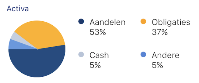

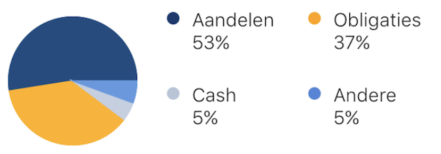

Like I said, I'm still clearly missing the actual correct code?
So image 1 is regular pie chart, you notice that first value ( dark blue ) is followed by orange rotated counterclockwise.
Second image is same pie with the rotate 180. So now all values are flipped over horizontal axes of the pie, but still fill up counterclockwise...
Any other ideas I can test?
- Newbie
- Posts: 22
- Joined: Tue Aug 08, 2017 12:00 am
Re: Pie Charts
Ok found out why this is happening... I added the values to the pie from large to small sorted. Seems the pie chart assumes that data is added in the other sorted direction ( from small to large ).
But because I also show a legend list, I sorted from big to small...
But problem fixed
But problem fixed
