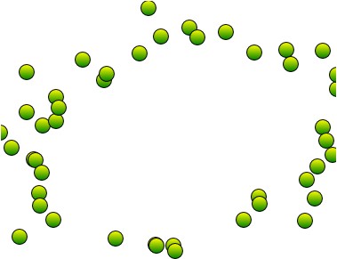

Currently I am working on a project in which I have to display a Bubble series. This project is being made in Silverlight and I am using TeeChart .NET 2010. I am facing a problem while doing following task:
I have a bubble series as in following figure:
Each pointer in this bubble series has a name. I have also a List which contains all the name of bubble pointers. Once I click on a particular item, a pie chart with certain values should be drawn at runtime at the same location of that particular selected pointer. In other word, at a certain event I have to add a small (just double radius size of bubble pointer) pie series above a particular pointer of bubble series.
I am trying to complete this task by taking help of Tee-Chart manual. Please suggest the simplest possible way…
