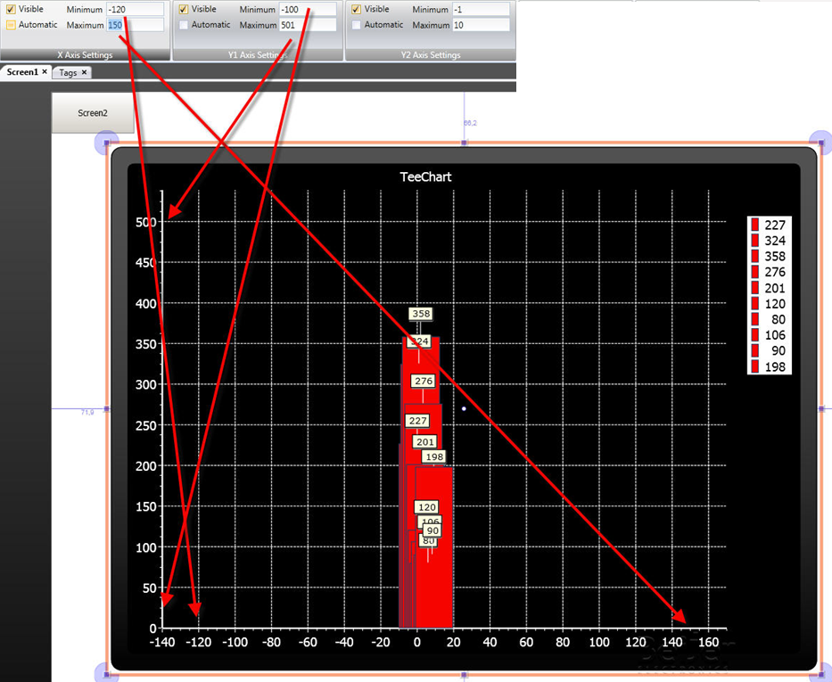

There is an extra margin added to the scale compared to the configured scale min/max values.
See the attached picture.
Is there a way to configure that the scale min/max correspond to the min/max properties?
- min_max_scale.png (363.5 KiB) Viewed 7649 times

These minimum and maximum offset values on the Axes are default set to 0, so that does not help.
The problem is very easy to reproduce, simply add some Y values to a bar chart and set a maximum Y value to 100, then when running the application the chart will most often add some extra “offset” value to the maximum Y on the axis so that it states 110 for example, instead of 100 as wanted.

The solution seems to be this row:
bar.Marks.Visible = false;
What does it do? Disables the "balloon" tooltips above each bar? So the only way to get the specific minimum and maximum value specified is when disabling the marks, is this a correct behavior?

The MinValue and MaxValue properties on XValues and YValues on a series are readonly and cannot be assigned.
This sample shows the problem, but disabling the Marks property solves the problem but what if I want the Marks visible also?

Ok. I think you can solve your problem changing the MaximumOffset or MinimOffset. In your case I recommend change MaximumOffset from 0 to 1 as do in next example:
Can you please, tell us if previous code works as you expect?
