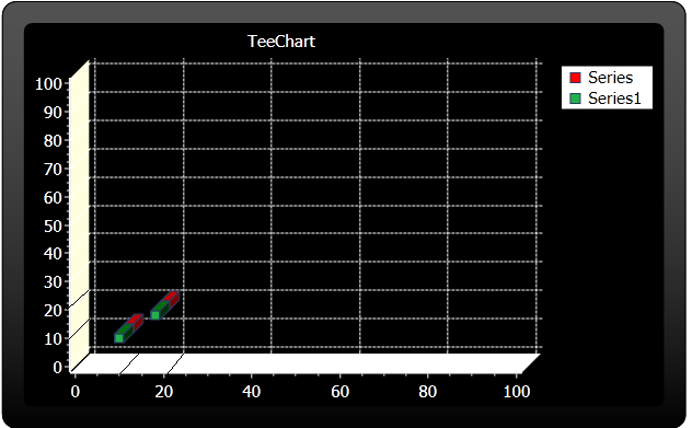

Is there any way to get some grid help lines for the Y and X axis in 3D mode?
It is hard to read the actual value
See attached picture (where values are 10,10 & 18,18 for both series)

No, we do not want to have minor grids visible, but 3D lines for the major grid. See the picture below:

We use the latest release version, but I see now that they are there, but the lines are almost impossible to see since we use a grid color set as white, and white lines on the yellow 3D surface makes it almost impossible to see. Is there a seperate color setting for the 3D grid lines, so that we still can use white as the major grid line color?

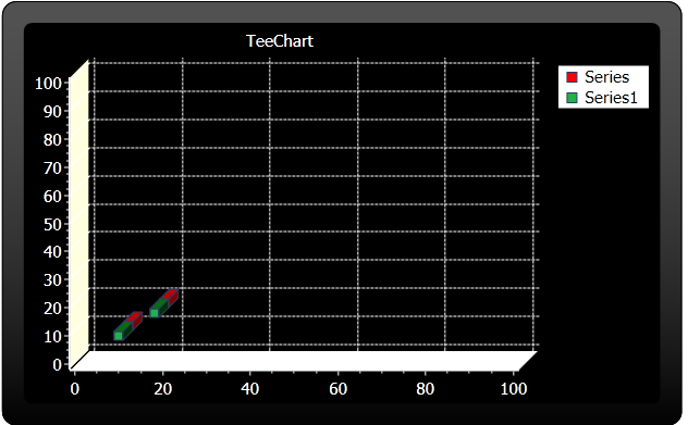

I think you can set the minor grid of a color and Grid of other color. You can do something as next code:
            Steema.TeeChart.Styles.Points Series1 = new Points(tChart1.Chart);
            Steema.TeeChart.Styles.Points Series2 = new Points(tChart1.Chart);
            Series1.Add(10, 10);
            Series1.Add(18, 18);
            Series2.DataSource = Series1;
            Series2.RefreshSeries();
            tChart1.Axes.Bottom.SetMinMax(10, 100);
            tChart1.Axes.Left.SetMinMax(10, 100);
            tChart1.Axes.Bottom.MinorGrid.Visible = true;
            tChart1.Axes.Left.MinorGrid.Visible = true;
            tChart1.Axes.Left.Grid.Color = Color.White;
            tChart1.Axes.Left.MinorGrid.Color = Color.Gray;
            tChart1.Axes.Bottom.Grid.Color = Color.White;
            tChart1.Axes.Bottom.MinorGrid.Color = Color.Gray;
            tChart1.Walls.Back.Gradient.Visible=false;
            tChart1.Walls.Back.Transparency = 100;
            tChart1.Panel.Color= Color.Black;
            tChart1.Panel.Gradient.Visible = false;
Can you tell us if previous code works as you expected?
